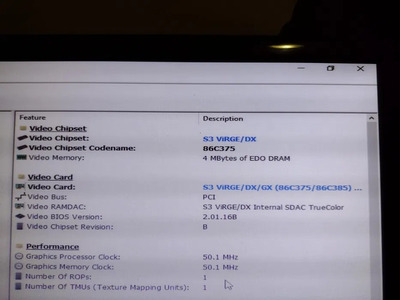

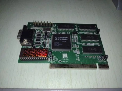

Thank you for the reply. What about the Diamond card?
I am concerned also about vga quality, since I heard S3 Virge DX has low quality output. The S3 Virge looks like this. Seems to be Eagle.

Reply 4 of 5, by Gmlb256
I refrained from mentioning the Diamond card due to having a BIOS with minor compatibility issues with some DOS games according to Gona's list, however it is a S3 video card (Trio64 or Vision968, the latter usually having a external RAMDAC like Matrox Millenium cards).
The output quality of the S3 ViRGE/DX varies between manufacturer, but yours is clearly a noname one and has a low memory clock (50 MHz) which isn't great. The best ones have a memory clock around 60-75MHz.
