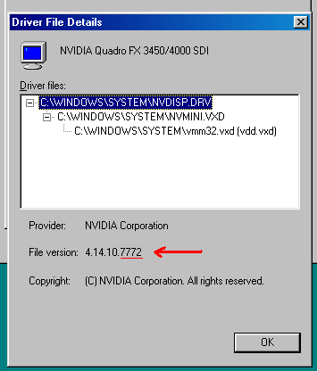

So most people that have wanted to run max hardware on Windows 98 already know about the shutdown bug with Forceware 81.98.
But you want the best fastest hardware for no real reason. 😁

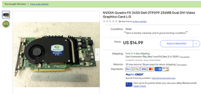

Well they cost a lot on Ebay. 2,3,4 500$ USD right?
Well the nVidia Quadro FX 3450 has the same Chip as the 6800 series.
But you can buy them for 15$ 30$ on ebay. But if you install 81.98 you end up with the same shutdown problem, and 77.72 doesn't detect it.
Solution;
Download the 77.72 for Win9x, extract it. Find the NVAGP.INF and add these lines to the right spots.
[Mfg]
%NVIDIA&DEV_00CD.DeviceDesc% = NV30, PCI\VEN_10DE&DEV_00CD
[Strings]
NVIDIA&DEV_00CD.DeviceDesc="NVIDIA Quadro FX 3450/4000 SDI"
Then install the drivers. Presto it works, and the computer shuts down and turns off automatically like it is suppose to. No crap patch required.
Thus 6800 NV41 series for 15$
Not saying it'll work for you, but my games launch, and my system shuts off on shutdown. I've had no issues since.
    350.97 KiB
    1393 views
    Proof of cost
    7.34 KiB
    1393 views
    Proof of install on 98
Reply 2 of 13, by thehinac
ebay search 6800 ultra. non-apple pcie range from 300-700$ not talking about lesser models. 7 series under win98 is too buggy. It's not really a consideration for a stable system in max compatibility.

Reply 5 of 13, by Warlord
all youre doing here is editing the inf and adding the hardware ID of the card. It's good that it fixed your specific problem, it allows a card that is supported by a driver, but the hardware id isn't listed there.
For example the 45.23 driver support FX series cards but only the 5200 is listed, you can go and add the ID for a 5900 a 5950 etc. Then the driver installs properly.
Youre not having to Force install anything like how I always see people post here about how they forced a 5900 to install. Its nonsense and it shows a total lack of understanding how things work.
Youre not doing anything here that actually fix the real problem and Id like to add on my 6800 GT OC I never had any shut down problem to begin with.
But it makes me wonder how many systems are affected by incorrect driver installs by forcing hardware instead of just editing the INF, and they have shut down issues but its not the same shut down issue its one they actually created.
