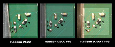

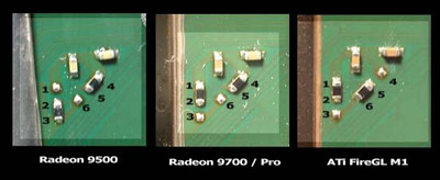

You cannot flash it to unlock the pipes without modifying resistors on gpu package. There is group of 4 resistors that control pipe quads and whether the card is firegl or Radeon. Softmd is most convenient. Flash works only for clocks.

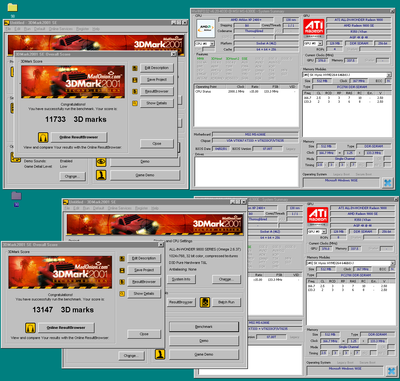

I have a copy of rad_w9x_omega_2637 (catalyst 4.2) driver which worked fine in w98 with the unofficial update pack installed. Picture shows the score difference of the unlock.
227.43 KiB
1126 views

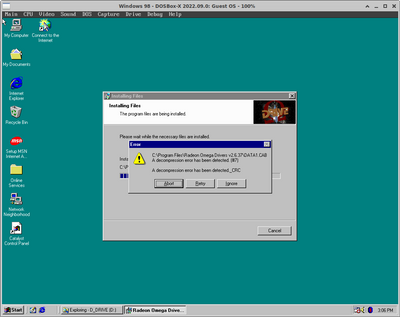

if you have a good copy of the 2637 installer you should upload it. i get this from everything i've been able to download:
33.62 KiB
1073 views

stanwebber wrote on 2023-01-02, 21:10:
I checked my copy is identical to the site linked. Are you sure you don't have some hardware / software mismatch? The omega installer also includes 2 extra programs for switching resolution and overclocking if I remember correctly.

yeah, your upload has the identical hash. i'm not sure what's going on, but i ran the installer under win7 and there was no crc error so i copied the extracted files to win98se and the drivers installed fine. ultimately, i reverted back to the last ati released driver (4.15.1.9165) and used a rivatuner script to unlock the pipelines.
