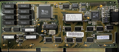

Recently I got this somewhat rare card:
552.53 KiB
922 views
ECS VI-811/833
It looks like VLB but it's actually ECS Local Bus, one of several custom pre-VLB local bus implementations. It unfortunately uses exactly the same connector, which has likely caused some to mistake it for a VLB card, with possibly disastrous consequences.

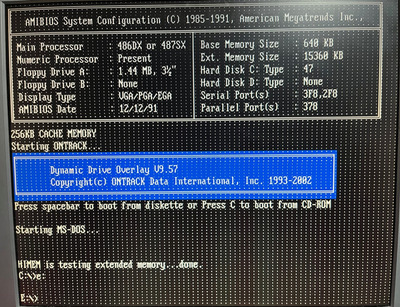

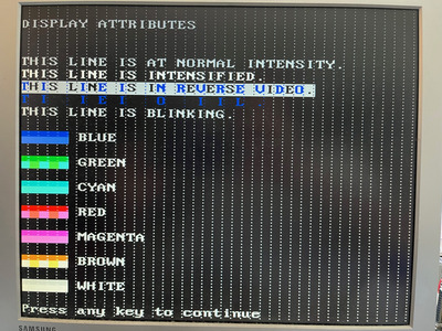

Anyway, I've been testing the card with an ECS SL-486E motherboard. It had been working perfectly (runs at 50MHz bus!), but unfortunately today it started artifacting after running a Doom timedemo. This is how text mode looks like:
960.28 KiB
922 views
Text mode artifacts

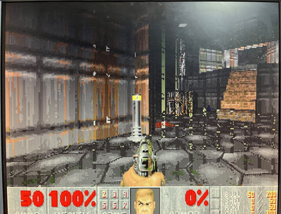

And this is Doom:
657.14 KiB
922 views
DOOM artifacts

Well, the artifacts in text mode look like local bus data bus bit D8 is broken (stuck high) during font upload. You see broken bright pixel every 4 scan lines, the first one on the second scan line of a character. On the other hand, I don't see any bad text output, which first made me believe that D8 is fine during text output. Thinking more about it, D8 is the "foreground color contains blue" bit, which is set for all characters on screen anyway, so I have no way of knowing whether D8 is broken for character output. To verify my hypothesis that D8 is broken on the path from the CPU to the ET4000AX chip (I'm very confident the issue happens between CPU and ET4000, not between ET4000 and RAM), please run a text mode program that uses blue-less foreground colors. If there is still blue in them (e.g. yellow text looks white, inverted text is darkblue-on-gray instead of black-on-gray) on every second character, this further confirms that hypothesis. At the ET4000AX, D8 and D24 are handled using the same pin, because the ET4000 only has a 16-bit bus interface, so D16-D31 are mapped to D0-D15 using external logic. Furthermore, also A8 (the address bit) is at the same pin of the ET4000 processor. The ET4000 selectes whether it needs to be connected to the address or data bus at any time. A8 and D24 are working, though (otherwise you would get 8 errorneous bright pixels instead of 4 errorneous bright pixels per scan text line (for D24 broken), and blocks of repeated patterns (for A8 broken)). Nevertheless, it might be useful to know that A8/D8/D24 is on pin 56 of the ET4000AX chip. The connection of that ET4000 pin to the bus pins is performed using some of the (74)F244 and (74)F245 chips on the card. I can't fully reverse engineer which chips are used for A8/D8/D24, as I don't have a photo of the back of the card (and I can't look at the traces below the chips). Most likely, pin 2 of U19 is connected to that ET4000 pin. This pin gets forwarded to pin 18 of the same chip in either direction (depending on read/write). So pin 18 of U19 is either local bus D8 or local bus D24 (from the order of the pins at the local bus connector, my bet is on D24). Using a continuity tester, you should be able to find another F245 chip that shares pin 1 with U19, which is supposed to connect the ET4000 to the other data bus pin (which would be D8).
The symptom looks like the trace between D8 on the local bus and the other 74F245 is broken, or that 74F245 itself is broken. Also, you could try a different ECS local bus graphics card to rule out damage on the motherboard (just kidding about having another ECS local bust card at hand, but the issue could indeed be on the motherboard as well as on the card).

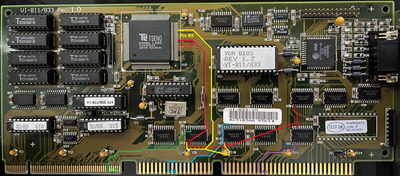

So, here's the connections that I've been able to determine so far:
558.77 KiB
807 views
VI-811/833 traces
Looks like U23 would be the chip that handles D8 (at least is connected to the ISA D8 pin, not sure how this works in a local bus configuration), while the ISA A8 is connected to pin 2 of U31. Seems U23 could be a good candidate for removal and testing (and possible replacement) as I don't see any broken traces there...
Also I am attaching a VDIAG screenshot that supports your hypothesis about D8 being stuck.

Reply 6 of 17, by mkarcher
TheMobRules wrote on 2023-01-06, 22:10:
I wondered just as you did about the ISA connection, which I first suspected to be used for local bus transfers, too. But then it ocurred to me that possibly that card takes some cycles on ISA, and other cycles on the local bus (e.g. if the ECS local bus can't do I/O cycles): You clearly see two F245 chips handling D16-D31, those are U18 and U19. You also see 16 traces to the local bus connector left to it, all ending on vias near L1. Chances are high these 16 traces are D0 to D15 from the local bus, and connected to the ET4000 through yet another F245, possibly U30 for D8-D15.
