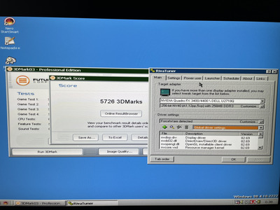

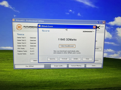

Hi, I'm trying these 2 VGAs and I don't understand why I have such a big difference at 3dmark. They are very similar cards
Computer and drivers are the same for both cards, I am swapping between one card and the other without even uninstalling the drivers
Specifications:
https://www.techpowerup.com/gpu-specs/quadro-fx-3450.c1368
https://www.techpowerup.com/gpu-specs/quadro-fx-3400.c1367
With the 3450 I get about 12000 points.
1002.88 KiB
466 views
With the 3400 about 5700
1.52 MiB
466 views
Why the difference? Is the 3400 broken?

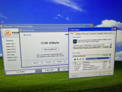

Reply 1 of 12, by matti157
I tried to unlock the 16 pipelines with Rivatuner but gained only little, I don't understand. 3450 kills it

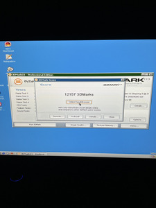

Reply 2 of 12, by matti157
And now, Afterhours unlocking pipelines, I overclocked it to 400/1000 like a 6800GT
But the result is 6800 😅
6800gt: https://www.techpowerup.com/gpu-specs/geforce-6800-gt.c130
But why is the 3450 much faster despite now also having fewer pipelines? I am going crazy

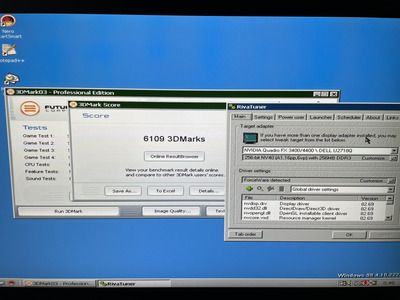

Reply 4 of 12, by Imperious
Must be driver related. I suspect if You were using WinXP with non modded drivers You wouldn't have this issue.
Justout of curiosity what are the rest of the system specs?
Reply 5 of 12, by matti157
Tomorrow I try with xp
I saw now that Nvidia, however, has made official drivers for 9x that support the 6XXX series and the Quadro 3XXX. I don't need to install the unofficial ones then https://www.nvidia.com/it-it/drivers/win9x-archive/

Reply 9 of 12, by matti157
Imperious wrote on 2023-02-09, 00:21:
You won. On Windows XP with the latest available driver these are the results:
Stock
1.92 MiB
321 views
16 pipelines unlocked
1.87 MiB
321 views
Now I have to figure out which driver to use on Windows 98, I don't want to be forced to switch to XP
