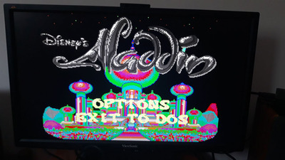

That happens too with other games, like Frontier: First Encounters. I mean the gibberish writing to VGA memory.

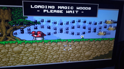

Games seem to have a hard time working. For example
-SuperFrog looks like this:
153.04 KiB
1654 views

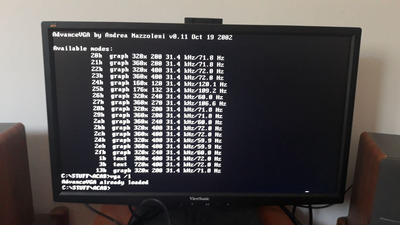

Well, VINFO doesn't report any video modes on HD 500, but there's this "AdvanceCAB" set of utilities, available here:
http://mirrors.arcadecontrols.com/AdvanceMAME … b-download.html
The inlcuded utility called VGA.EXE can detect these modes on the HD 500:
116.5 KiB
1559 views
However, after loading this "VGA" TSR, Prince of Persia is still unable to find the VGA, and Aladding still works like this:
116.5 KiB
1559 views
..which leads me to think that HD 500 is reeeeaaaally flawed for DOS, way beyond VESA modes availability.
