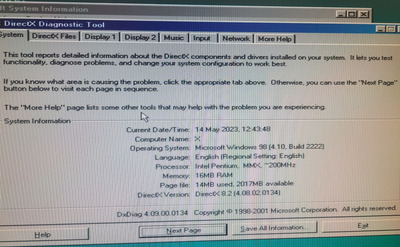

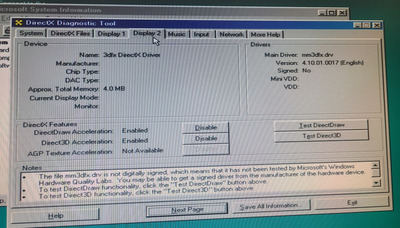

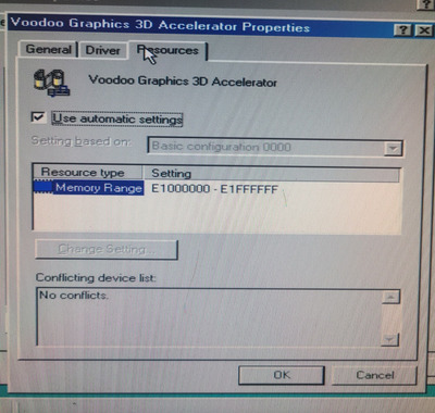

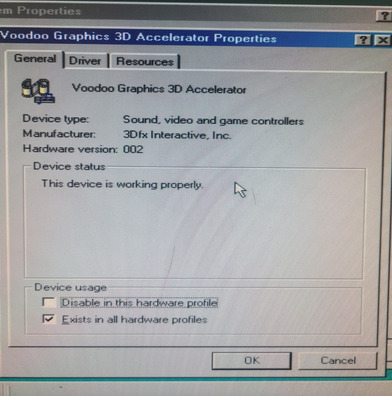

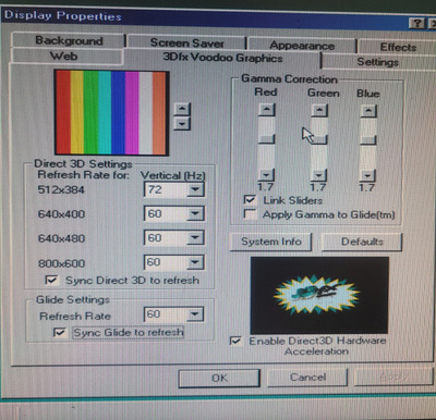

Hi, got Voodoo 1 to play with... bought it as non working. Few capacitors damaged or missing. Checked pin legs, resistors fine. After fixing that windows 98se recognise it, installs drivers etc. All seems OK but can't see anything when trying to run d3d test in dxdiag just a black screen and after that ask8ng me if I see this and that. Donut demo starts and closes immediately. Don't know if I need any special drivers or I'm missing something. It's a fresh install of win98se with direct 8 installed. Tried with dx7 too and same thing. Pics attached.
Don't know what to try. Any help appreciated.
Thanks

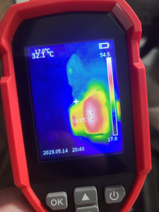

Also nearly 55 Celsius on tmu with no load. Is it normal? ...

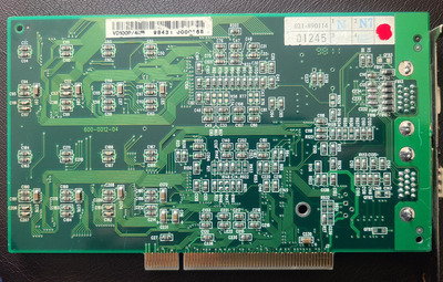

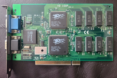

Reply 3 of 32, by Rwolf
I don't have exactly these, but some of the online photos I see of them do have a couple of heatsinks on the 3Dfx chips.
Looking at some pictures at a museum site: http://hw-museum.cz/vga/3/a-trend-helios-3d
I can see some components that differs (in the middle of the back side):
R148: you have this mounted - the other board has not.
R149: you have this missing - other board has it mounted.

Reply 5 of 32, by drosse1meyer
you shouldnt need heatsinks for voodoo1. even voodoo2 didnt come with heatsinks. however its not a bad idea to finagle a cooling solution for longevity's sake.

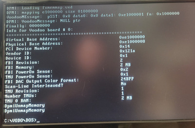

Reply 7 of 32, by Robx66
So I did run MOJO and that's what I got from it...
Screen capture as well from mojo without log and log as you can see underneath.

Reply 8 of 32, by drosse1meyer
I'm not an expert on mojo.exe but the output looks OK. Detects the FBI, TMU, memory and doesnt hang at any point. Have you tried the DOS tomb raider 3dfx ver? (This could point to a problem with your Windows 3dfx drivers and/or installation)

OP is testing it on a Pentium 200MMX computer if you look the second picture which displays DxDiag.

I thought the same, but second screenshot (DirectX diags) shows a P1 MMX. Yes detection might be completely wrong, but with 16MB RAM it's unlikely that it is something too fast like a PIII
