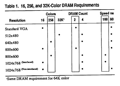

With 100 ns DRAM, certain modes are unavailable:
66.71 KiB
954 views
Note that the datasheet is most likely mistaken here - it doesn't make sense for 800x600x16 to require faster memory than 800x600x256.
Anyway, I'm calling this mystery solved.

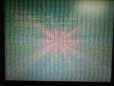

wbc wrote on 2023-06-01, 16:12:
Do those artifacts are static or flickering/shimmering over time?
They are flickering.
Try to set 800x600 256-color mode for 60hz refresh then run any VESA application that use this mode (i.e. VBETEST from SciTech Dispaly Doctor) and check if the image is correct and stable.
I can't do it except in safe mode. After restarting the screen becomes unreadable.
Which version of SciTech Dispaly Doctor do you prefer me to use? The Windows version or DOS?
Constantly looking for the driver for Acer Magic v1 MPEG decoding card.

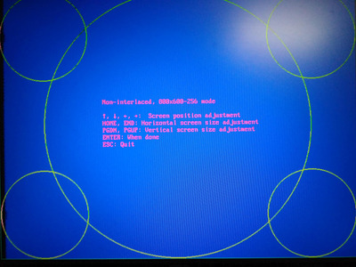

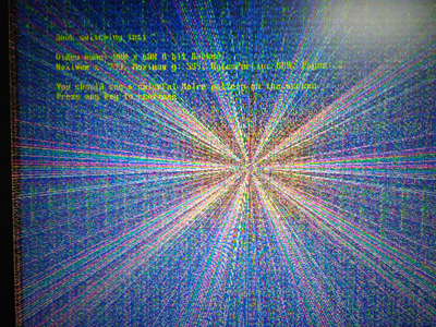

wbc wrote on 2023-06-01, 17:21:
the DOS one, 5.3a should be enough
I'm sorry, I forgot to set the color mode first. The result is a little better now!
1.04 MiB
911 views
Still unusable, but it's static and I can barely see the text now!

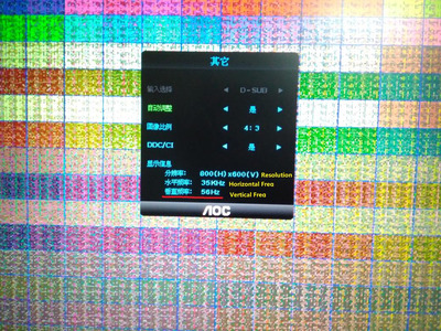

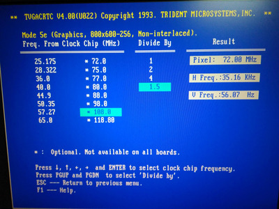

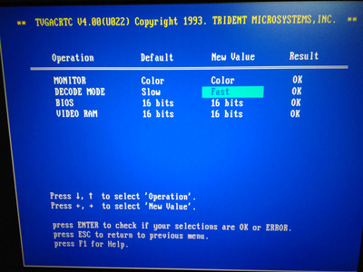

It turns out I hadn't set the vga correctly before. I created my own monitor profile in tvgacrtc but not saving the settings. Now I use the Anymaker 60Hz profile and set the 800x600-256 mode as 108Mhz | Divide By 1.5 result in 56.07Hz and it works in TVGACRTC the first time. Though in VBETEST it still a lot of artifacts.
313.84 KiB
883 views
315.14 KiB
883 views
856.34 KiB
883 views
BTW, I find a setting in TVGACRTC by pressing F10, the Decode Mode. I can set it to Fast, but every time I enter the page it shows Slow. How can I set it to Fast permanently?
214.62 KiB
883 views

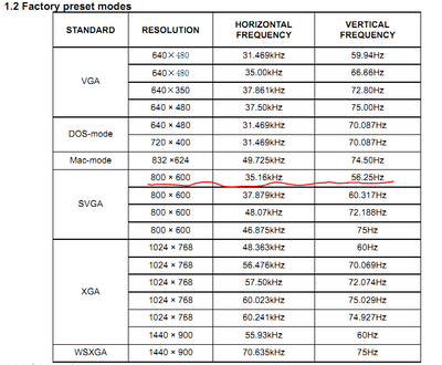

GunKneeNeon wrote on 2023-06-01, 20:04:
wbc wrote on 2023-06-01, 19:33:
couldn't find any detailed info (or even manual) for your monitor
Maybe you could search for AOC 931Sw instead, it's more popular and the model number are very close to mine.
aaand this one becoming even more cryptic, as the service manual states that 800x600 56Hz is indeed supported:
71.06 KiB
878 views
Could you connect the monitor to more recent PC with VGA output and try 800x600 56Hz mode there?

Here is the interesting part, both 108.0MHz | divide by 1.5 and 72.0MHz | divide by 1 output the exactly 56.07Hz refresh rate and the monitor was proved to be able to work at 56Hz refresh rate (see my last post). Why one displays just fine while the other causes the Input Not Supported error?
