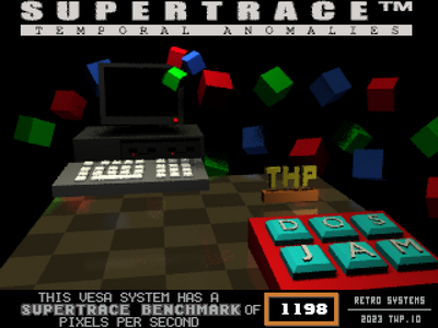

As part of the currently-running DOS Games Jam June 2023 Edition I decided to create a new DOS benchmarking tool for VESA cards (as a fallback it also support VGA). It really benchmarks the CPU more than the video card, though, but it might be interesting to see if there are any differences between different cards and VESA BIOS Extensions. My gut feeling is that it will be CPU-bound anyway, but you never know.
This is not intented to be a Serious Benchmark (although it can probably be used as one!) but a fun little diversion and something new to run on your old hardware with DOS graphics cards.
It does feature mouse support and keyboard navigation for navigating the scene (yes, it's ray traced, not just a static picture that's slowly loaded onto your screen...) and there's an easter egg hidden somewhere you can't see from the default vantage point. Happy hunting!

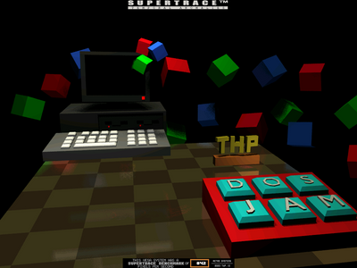

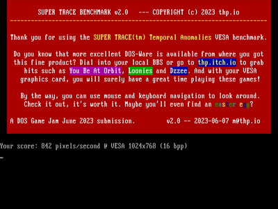

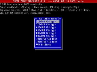

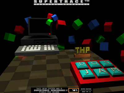

Turns out 320x240x32bpp isn't well supported in many cards (at least not with UNIVBE). Fixed this now with support for more screen resolutions and a fancy selector.
Build in original post will be updated with the new version.
Updated version 2.0:
  • Fixed text (DOS Game Jam year)
  • Add support for 24 bpp and 16 bpp VESA modes
  • Add support for 640x480, 800x600 and 1024x768 modes
  • Add benchmarking support for VGA fallback mode
  • Add dialog to choose resolution/depth on startup
  • Display benchmark results on exit (if benchmark completed)

Voodoo3 cards seem to have a buggy BIOS for 24bpp modes. This was already mentioned in another Vogons thread.
If the VESA OEM string suggests a Voodoo-based card is in use, the program will now print a warning that the user should load VESAFIX before using the VESA modes (or the program might crash with a division error).
Also, the 24bpp mode wasn't properly tested in version 2.0, so the byte order was wrong (red and blue channels were swapped). This is now fixed in version 2.1.
