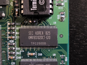

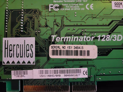

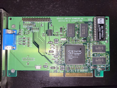

Hi! here are some pics from one of the cards.

Reply 4 of 14, by technokater
The SEC KM416S1020CT-G10 is a 512K x16 Bit x 2 Bank SDRAM chip rated at 100 MHz. Each chip is 2 MB, 4 chips means 8 MB in total. If it isn't a hardware defect (which would be weird because usually you have artifacts or the card doesn't work at all), I suspect a software issue. Did you check if there is an option in the BIOS to limit video or PCI frame buffer memory?
Reply 5 of 14, by Gmlb256
It is usually a hardware limitation. I do have a S3 Trio3D/2X card with 8 MB but it only uses the first 4 MB for the framebuffer and the rest gets reserved for GDI and 3D stuff. This can be observed with the PowerStrip utility.

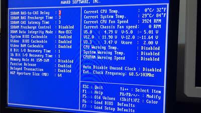

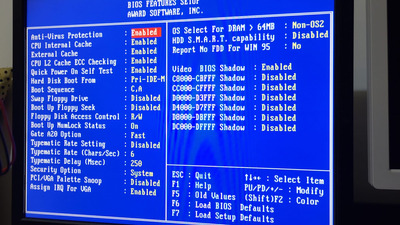

Hi! I have attached the photos from my Tekram Slot 1 BIOS. Can someone figure out which option might affect the card?

Reply 7 of 14, by technokater
Since you are using Windows, I would disable the following options:
  • System BIOS Cacheable
  • Video BIOS Cacheable
  • Video RAM Cacheable
  • Video BIOS Shadow
I don't think this is directly related but those settings are leftovers from ancient days and might cause trouble.
You do seem to have a slight overclock of the external bus active though. Ext. Clock Frequency is set to 68.5 / 103 MHz, non-OC would be 66 / 100 MHz I guess. I'm not 100 % if that's AGP or FSB setting but it does look odd. I would give it a try and lower it, because the PCI and AGP frequency are likely derived from this setting.
