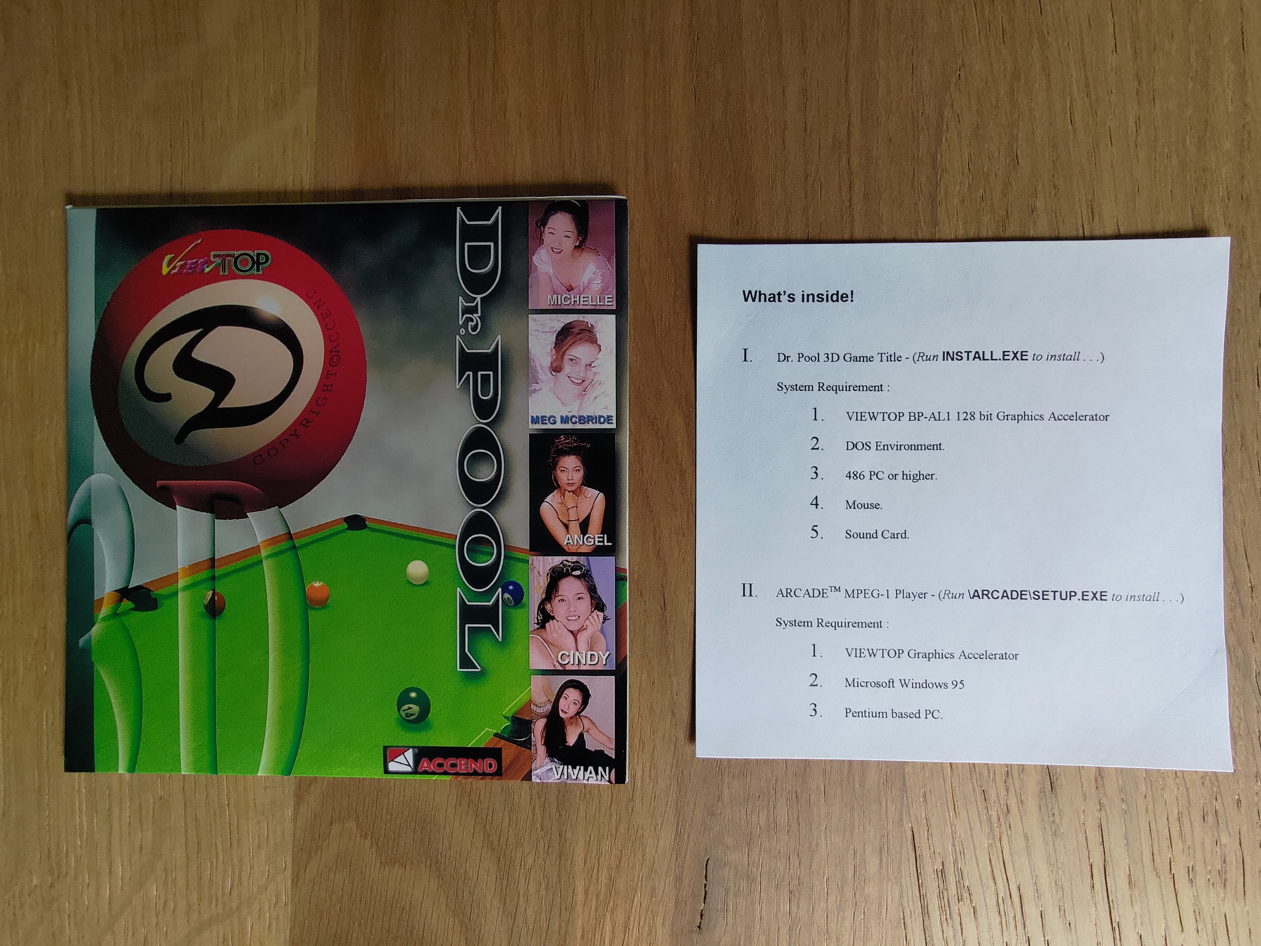

Ok, I received the thing...weird s*it indeed! Just a bland cdrom paper sleeve and a piece of toilet paper as manual 🤮
Oh my frickin' gawd! I can't believe it, an unknown msdos game, today ...in 2024! SHOCK!
I wonder where da fuq my provider took it from... the illuminati? 🤣
The piece of paper babbles about an exotic video card as requirement... nonsense I think...

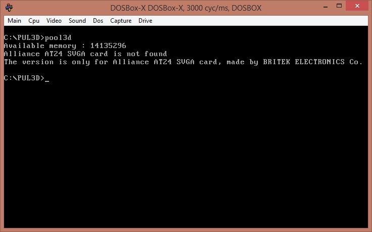

Then I install and run the game in a Dosbox window and the nonsense becomes reality 🤦
Yeah I know it's a dosbox-x screenshot, too lazy to make another one for vanilla dosbox, same result.
Some infos about the required card here, infos about the chipset here.

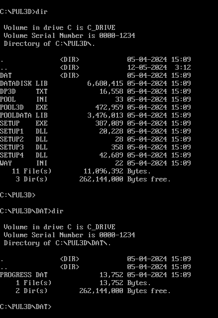

Somebody suggested me hacking the exe to bypass graphic card check is the only way to have some hope this can run but oh well...

Interesting stuff. I can't imagine the software uses any special capabilities of the card, seems more like a hardware lock as it is OEM software. I'm wondering if it'll work with a Voodoo Rush (with the AT25 chip), even though that doesn't exactly use the same chipset.

Sounds like the card has basic MPEG-1 hardware decoding so that could be a factor, given the box art...

Nice observation. The cdrom includes the msdos game and a MPEG player for Windows. However manual txt has no mentions of fmvs and the full game is like 18megs.

Nope, but maybe it will work with this.

I guess I made some progress (facepalm).
This is the result with an AT24 VGA card.
After the graphic card lock, mouse driver is mandatory.

Maybe you need the at24 MS-DOS driver listed at Britek Drivers Download but it wasn't archived.
