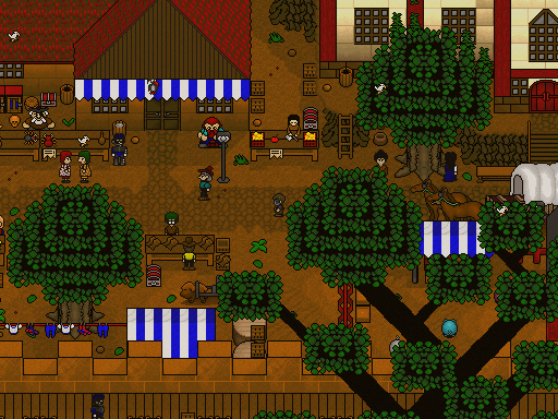

There was a nice (albeit unfinished) game called The Curse of Dragmoria, made with Verge engine (DOS version 2.01a). It was made by a couple of Finnish goth guys, and had quite an unusual graphics, atmosphere and battle system, too.
I remember playing it on my old computer, but now I definitely can't run it, even with DOSBox, getting some "page fault" message. Any ideas?

This game was apparently designed to work in the NTVDM and not real DOS, but you can avoid the pagefault in DOSBox by disabling DPMI 1.0 extensions:
cwsdpmi -x
verge
Optionally, you can use CWSPARAM.EXE to change the run option flags from 0 to 4 (the parameters are written into CWSDPMI.EXE), then you don't have to preload the DPMI server with the -x switch.
Having dealt with the initial pagefault, other problems stemming from NTVDM behaviors may arise. For example, the files xplosion1.wav and xplosion2.wav exceed 8 characters in the filename. If the game tries to access the files with their long names then it may abort, or at least fail to play the sounds.
