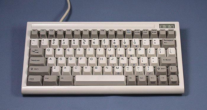

I was hoping for one that is for all games. The reason is that I try to avoid modding my new keyboard, which has strange arrowkeys arrangement.
