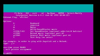

Does the Day of The Tentacle run on a 8086 or 80186 CPU? If it doesn't, it needs a 80286 to work(since it won't run 80286+ instructions on those CPUs). The 80286 only adds new instructions for entering and managing protected mode, so if it doesn't use Protected Mode, it should run on a 8086 or 80186(NEC V20/V30) CPU. Using UniPCemu's NEC V30 emulation(actually 80186) with EMS memory should work if it doesn't use protected mode(the only non-0F opcode added on a 80286 is an instruction that only works in protected mode, after all).
Edit: Just tried it on UniPCemu's 80186 with the current commit and bugfixes:
83.65 KiB
1591 views
Result of running Day of The Tentacle on an emulated XT NEC V30(80186).
Although, this could also be a bug in the CPU. Does this happen on a real PC XT as well?
UniPCemu Git repository
At least it does not work on a 8086/8088, as it uses for example SHL register by 3.
I bet they put the 286 CPU as requirement, as for normal people, they were called 286 instructions.
So, it might work on CPUs implementing the 80186 instruction set such as V20/V30 as well, but people having those CPUs would be marginal, and it would not run it that well.
Game requirements also said the CD-ROM version requires a 386, but in reality it looks like it works on a 286 as well, so these might be suggestions for adequate performance, not hard requirements. I mean, they suggest 2MB of EMS as well, but it also appears to work without EMS.
Reply 36 of 37, by superfury
Thinking about it, the 80386 might only be needed for the CD-ROM interface? Otherwise, a 80286/80186(NEC V20/30) should work as well.
