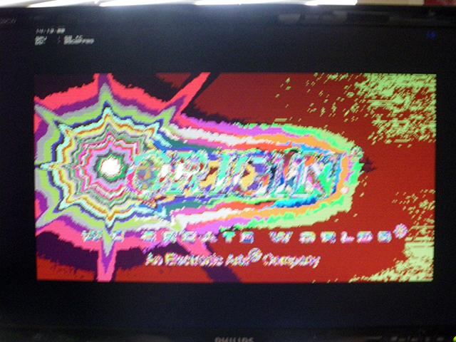

i know the problem with the Psychedleic/garbled colors under windows 7 in Direct Draw with old games. i use the Ultimate x64. My solution is really simple. just kill the "explorer.exe" and start the old game. All colors right. I tested this with Wing Commander 3 and UFO game and sanatarium.
Edit: for Kill type in CMD or Start-execute: "taskkill /f /im explorer.exe" for Reload: "explorer.exe"
First Pic with "Explorer(exe) disabled". Second with aktiv Explorer(exe)"
Reply 8 of 57, by Good Ol' TarviS
This patch allows you to fix it without having to make a batch file or closing explorer.exe beforehand. Like previously said, it does not actually modify the game .exe, but it uses data from it to generate registry entries that make DirectDraw behave properly.
