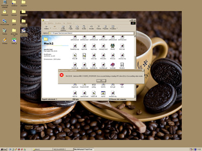

Reply 22 of 22, by biessea
And sometimes after it load the mission it crashes with this error:
    433.23 KiB
    357 views
    3dfx voodoo2 mech2 error crash
