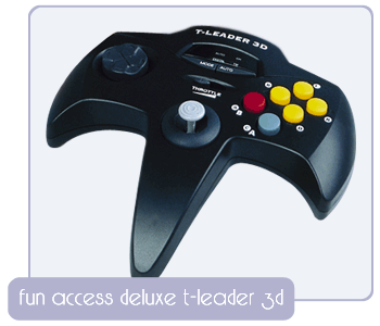

Been looking at my P200 with a 3DFX but didn't have the motivation to plug it in along with the 30kg ! CRT sitting next to it 😀 I recently got hold of this gamepad, probably the one with the most buttons you can find for DOS/Win9X but well, it's not really precise (analog thumb) and it's not as comfortable as an XBOX 360 controller :

That looks a lot like a N64 controller, which was one of the wackiest looking game controllers I ever used. The only one that look more toy-ish than that was the Gamecube controller. Even the Dreamcast controller was more serious looking.

oh and yes, about this controller it's a little the same, you cannot play with it for too long, borders are so sharp they literally eat you 😀))
