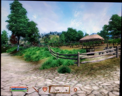

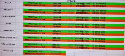

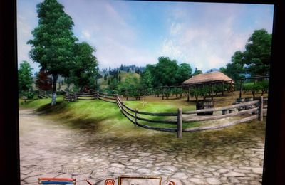

I know this is an older post; but still not addressed in 2022; additionally for my 7900 GTX, besides Far Cry, TES IV: Oblivion (Vanilla no mods) does not populate grass; but with 175.19 driver the game displays as it should.
I also found an interesting issue where the latest driver for the HD 3870 512mb performed far worse than older driver in several games; and the difference was going fron unplayable on new driver to playable on older driver.
This is on a QX6700@3.2Ghz with 2x2GB RAM @1066Mhz.

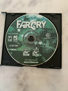

Does anyone know what the 6th CD is that's included with the retail release? The readme nor the instruction booklet explain what it's used for. The CD case says it's a 5 disc package but there is a 6th disc labeled, "AMD64 - Not For Resale", without any "Install" or numbering text like the other CDs. Is this the 64-bit setup or something?
EDIT: Here's a pic of the CD
222.6 KiB
564 views
AMD Athlon 64 CD
Reply 375 of 386, by RetroGamer4Ever
That's the 64-bit install disc that installs the 64-bit version of the game that was developed by CryTek for sale with 64-bit AMD Athlon systems. From what I recall, that version was dumped and CryTek went back to distributing the 32-bit version, though people were getting copies of the 64-bit install and using it with the 32-bit version sold on digital distribution platforms.
