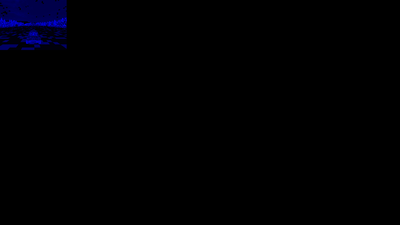

Hello everyone!
I have a problem with making my Colin McRae Rally 1 smooth. I am trying to use Microsoft Application Compatibility Tool to fix the low frame rate issue. Could you please tell me step by step what I should check when creating a database in this application? I do knot know exactly what settings are most appropriate (I use Windows 8.1, my graphic card is GeForce 970X). When I do it on my own I always end up with gameplay in...blue colours on a small screen in the top left corner of the monitor. By the way, when I enter the game settings in the main menu, the only option in graphic settings is 'no graphic card' (I use the Polish language version). Is it normal? Anyway, I cannot play the game as it displays only blue colours. I have installed the necessary patches. Please help! Thank you in advance.
PS. I forgot. It's not only about blue colours. The game does not detect the 3D graphic card at all.

    This is what I get (now I use Windows 10)
Reply 10 of 10, by Blade87
Sorry for being bothersome, but maybe now you could help me with this after uploading a gameplay printscreen
Edit:
Yeah! Finally it's working. If I had known that the problem was that simple I would have solved it much earlier. It was 'motion compensation' that should always remain off. So, forget 😉
