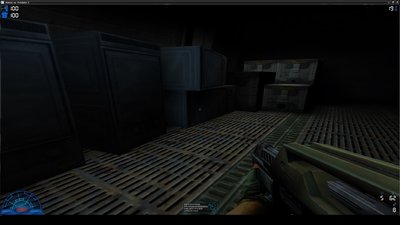

AVP2 works fine on my i5-2500K and GTX 770 under Windows 7 x64. The only problem that is bugging me is that the game doesn't support native AA and if you force it through the Nvidia Control panel, you get awful glitches around the edges that get worse as you progress through the game. (see attachment). I tried using dgVoodoo 2.53 D3D and using 8xAA, but you still get awful ragged edges. I've also noticed the same problem in NOLF 2. Anyone know of a fix for this?
Thanks! 😀
    257.76 KiB
    3053 views

HI Davros, I tried both. You still get jaggies with DSR and FXAA works but it makes everything look blurry. I prefer Multisample anti-aliasing as it's looks better. If I can't find a fix, I'll probably just have to stick with FXAA instead.
