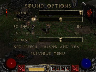

Reply 7 of 17, by Stretch
With my Guillemot Maxi Sound Fortissimo (YMF-744) in Win98SE, I can enable both 3d sound and Environmental Effects.
    83.75 KiB
    3769 views

Reply 8 of 17, by jonpol
Thanks for checking! Did you notice when you played the game whether any sounds were coming out of your rear speakers?

Reply 13 of 17, by Stretch
Had a free moment to try the Vortex 2 with driver 2041, and I was able to enable the 3D Sound option, but not the Environment FX.
The log file from Diablo 2 says EAX is not supported but implies I'm using DirectSound3d.
