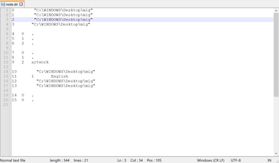

I followed gill's instructions, but I get the error message "The procedure entry point SymAddrIncludeInlineTrace could not be located in the dynamic link library DBGhelp.dll (in C:\Windows\System32)." Windows doesn't let me modify System32 and I can't successfully change the owner from TrustedInstaller. However, I have the portable MiG Alley install fully patched and with the other .dlls otherwise.
Is anyone able to check my roots.dir if it's been configured correctly? I currently have it on my Windows 10 desktop.

Reply 65 of 114, by tincup
goldmastersims wrote on 2021-06-20, 22:47:
...Is anyone able to check my roots.dir if it's been configured correctly? I currently have it on my Windows 10 desktop.
I believe your line 13 should simply read QUAD\.
Thats the folder you move all the Smacker files to if I remember correctly.
