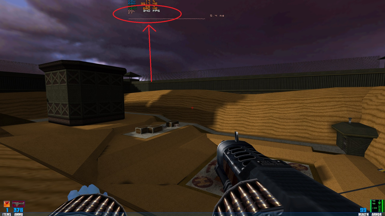

It's really strange, maybe the problem ARE the (maybe very old, 15 years old) profiles and not the lack thereof.....
Sin (no already existing profile) with MSAA 4x and AF 16x:
It's good, really good, but a GeForce 1050 Ti walls @500 FPS in the same conditions (500 FPS is the hardcoded limit)

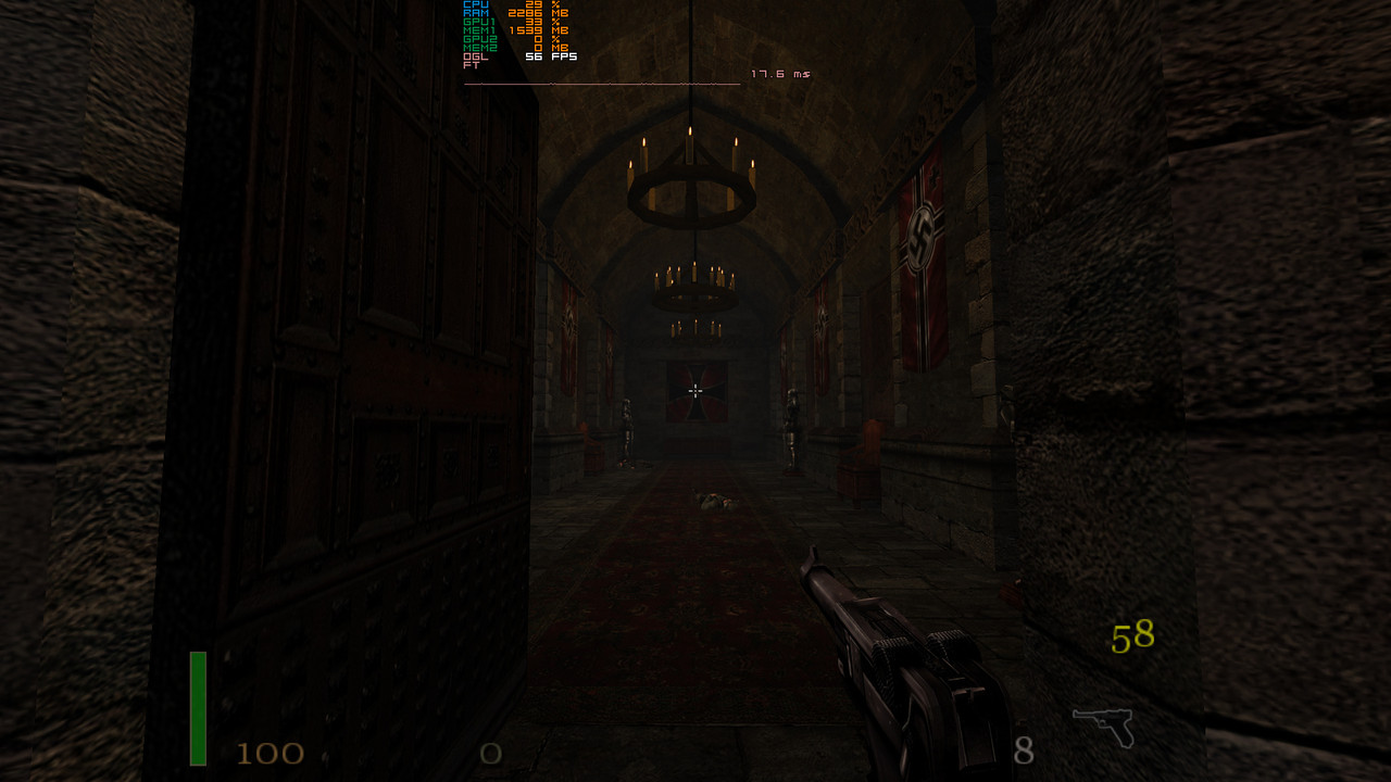

Here's the sad AMD Radeon situation (Catalyst 19.9.3) with OpenGL.....ioRTCW OpenGL 2.x + ESRGAN textures:
GeForce 1050 T:
Radeon RX 570:
It's.....sad 🙁 (rendering is correct but performance is lacking, see how the frame time is erratic)

It' a nice card/GPU but as expected the OpenGL driver is lacking compared to Nvidia one (but hey, the situation is better than years ago, compatibility is somehow assured eventually).
See the frame time fluctuation in ioRTCW "new" renderer! (the rasterization process is totally "unstable", there's a heavy frame time variance.....holding still ! ) With the old (original slightly modified) one the situation is less dramatic but a modest 1050 Ti can achieve 2/3 more performance.....
