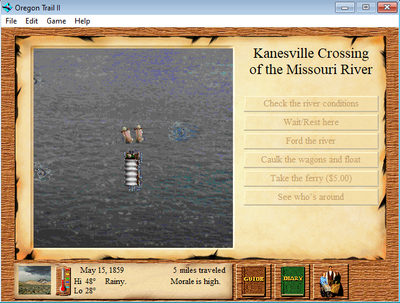

Reply 171 of 216, by CDrayan
I'd already posted how to get Oregon Trail II to run on Windows 11. Everything works, except for the river-crossing videos (the MECC logo and intro play just fine). Where in the USA is Carmen Sandiego has a similar issue where the Chief's movies don't show the video (the audio plays okay).
Both games use QuickTime 2.1 specifically; later versions won't work. It seems to a compatibility issue with Windows XP onward.

I installed OT2 and the QT installer is somewhat problematic. Since it's a 16-bit program, it requires OTVDM but the worst part is it installs to the OTVDM directory. Now I need to find a way to differentiate the files which were supposed to go to WINDOWS directory.

There is a 32-bit version of the QuickTime installer on the CD, QT32INST.EXE. Try that one. Just make sure to set compatibility to Windows 98.
Also, I found some source header files in DATA/QTW/INCLUDE. Wonder if they can help in making an XP fix for QuickTime 2.1...

Ok I was able to get the first intro to work. Can you tell where I can get the river crossing scene, so that I come to the problematic video?
And if possible, can you tell which are the video files used in river crossing scene?
Edit: Could you help with a few tips on how to play the game?

The videos are all in DATA/MOVIES. The river crossing videos are in the 4xxx range.
To start quickly and test crossing the river, just press the Quick Start button. It will start you out all ready to travel the trail.

Ok so I am supposed to check if the videos run before I go to the scene of Blue River or Missouri River or... And the video doesn't play here. Neither can DxWnd hook this part. This will be difficult but let's see.
Reply 179 of 216, by BEEN_Nath_58
@CDRayan It seems using the Windows 95 compatibility mode fixes the issue of the videos. Now I have to find out what thing in Windows 95 compatibility mode does it and we are good.
