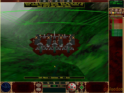

Also Direct3D rendering is resolution locked to 640x480. Obviously on a modern computer you can force higher with dgVoodoo:
742.41 KiB
858 views
But there's probably some issues with that. I found one very quickly (cursor trailing in menus).

On a old computer I managed to get it to 1024 768 I believe
🤔 are you sure it’s not glide? Huh... well, that totally eliminates any need I might have for a voodoo card then 🤣
Is there a specific direct 3d version that I should use?
What software and hardware is best for this game?
Dude that pic looks like max detail settings, now if only you could set a higher res..
What hardware/software is behind that image. Is it your image?
The software render supports 1024x768.
Sphere478 wrote on 2021-01-20, 15:47:
Just a standard modern computer, Windows 10 and dgVoodoo.

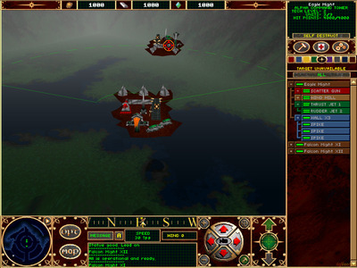

You can try searching strat.exe with a hex editor for:
00 89 3D A0 4E 54 00 EB 4C C7 05 A8 49 57 00 80 02 00 00 C7 05 AC 49 57 00 E0 01 00 00 EB 2A C7
and replacing it with:
00 89 3D A0 4E 54 00 EB 4C C7 05 A8 49 57 00 00 04 00 00 C7 05 AC 49 57 00 00 03 00 00 EB 2A C7
Not a lot of point if you're using dgVoodoo though, all it does it make the UI smaller and filled with unused space:

What is the hex doing? Keeping 640x480 but making the interface smaller?
Sphere's PCB projects.
Reply 6 of 11, by ZellSF
No it's probably setting 1024x768 as rendering resolution too. It's just not very relevant if you're forcing resolution anyway. And who knows why 1024x768 is disabled for the Direct3D render. Could be that it doesn't actually work well, or they decided to not make it available for performance reasons. I'm guessing the later.
