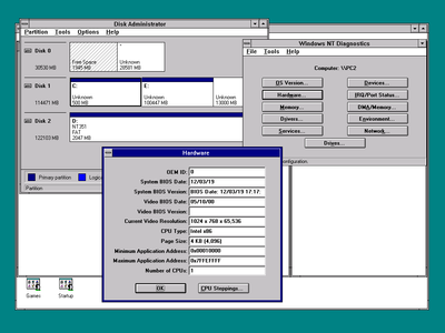

If anyone is looking for more info I have recently spent a lot of time with NT4 on a CF quad boot setup (FreeDOS/98SE on one 32GB CF and NT4/2000 on a second, using Boot-US for partition hiding).
There are some limitations that I had to overcome. 4 is especially important with CF cards
1) I partition the drive from a Windows 7 boot disk with diskpart. I clean the disk, set it as MBR, create a small (500MB) primary partition and leave the rest unused.
2) NT4 will only install to the drive set as primary in the bios (a slight lie, I can disable the first CF and the secondary becomes the only one detected in bios).
3) NT4 can install directly to NTFS, but only version 1.2 as formatted by NT4 (so no formatting with 2000 or later, or gparted etc)
4) The partition size limit during install for FAT16/NTFS with SP1 media is *not* 8GB, it is based on C/H/S values so may be considerably less (https://www.c-ad.bnl.gov/kinyip/windows/confi … oot_device.html)
For my 32GB industrial card the C/H/S values reported are 62041/16/63, this means all of NT4 must be installed in a partition below 500MB (1024 * 16 * 63, with 512 bytes per sector). If any files end up above this then install/boot will fail.
5) Once installed within the 500MB partition I can boot successfully. Once booted I install SP6a. After SP6a has installed (before reboot) I overwrite ntldr and ntdetect.com with the XP versions. This means I now have an install that supports larger drives.
6) I take an image of the drive with dos version of ghost from ghost solution suite 1.1
7) I restore the image over the drive and ghost expands the NTFS volume to fill the drive
This leaves me with a 16GB partition with a patched version of NT4 and XPs boot loader that allows it to boot with files above the C/H/S bios limit. I've not found any more modern tools that can cope with imaging NTFS 1.2. NT once updated to SP6 can run with a NTFS 3.0 (Windows 2000) partition, but chkdsk etc no longer work without hotfixes.
Edit: Oh and the CF must be set as a fixed disk, not removable.
