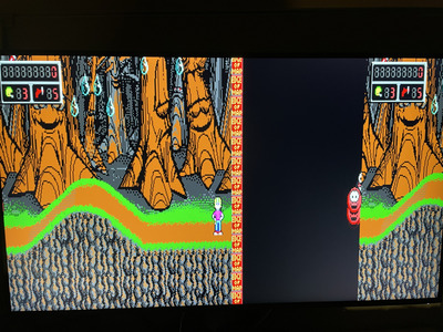

Hi,
first of all the game works correctly if I launch it from "pure" dos (i.e. if I boot Windows 98 in DOS mode)

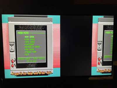

If instead I launch it from windows I get what you see in the picture, i.e. the game is rendered on the left side of the screen and on the right side the left side is repeated but in a strange way (the images are not the same, it looks like the "camera" is slightly shifted)
The video card is an Nvidia Quadro 3450
I also tried with this patch but nothing changes Re: Keen 4-5-6 choppy scrolling on EGA card

Reply 1 of 7, by Jo22
Commander Keen uses EGA graphics with double-buffering (two video pages, "dual-page mode").
Here's another program using it, albeit in 640x350 resolution.

Reply 2 of 7, by Gmlb256
Jo22 wrote on 2023-01-23, 02:48:
Windows never was good with DOS applications, I think..
This is kind of a misconception, while there are DOS applications with issues within Windows 9x, most of them works fine including the Commander Keen series. Seems to me that the problem is with the video card driver.
Only the NT-based versions of Windows weren't truly good with DOS applications.

matti157 wrote on 2023-01-23, 08:06:
Do you know how to solve it? Just do alt+tab to return to Windows and then reopen the DOS window from the taskbar. Mystery 😅
With the current video card, no. 🙁
If possible, try with a period correct one since the Quadro FX 3450 was made by the time DOS went out of mainstream support.
