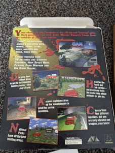

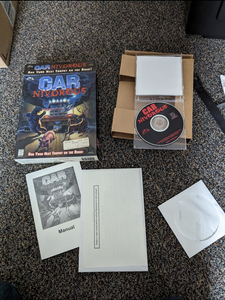

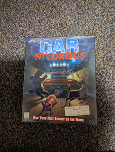

If anyone is curious, just for fun, I have pictures of the box and contents of Carnivorous too. There are no other pictures of these found online except a very old and blurry scan of the front box, and Mobygames is taking forever to process my scans.

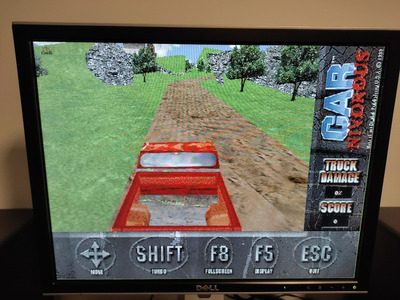

Reply 12 of 41, by konc
Just set the system date to something earlier like 1999 and you'll be surprised 😉 What a terrible little game, I love these oddities.
(PIII 1.2Ghz, 128MB RAM, Voodoo3 2000, Win98SE)

Reply 13 of 41, by Firtasik
Nice one, konc!
It does work with dgVoodoo2 on Windows 10 but the game runs too fast (limiting FPS helps).
Also there's no music. Does the original disc have audio tracks?
