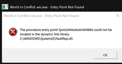

I've looked around online but it seems no one has figured out a fix for this. On my Windows 10 22H2 PC, World in Conflict won't launch if Directx 10 is forced in the config file. Anyone have any thoughts on how to get it to work?
My system specs:
4090 RTX
13900K
64GB RAM (5600Mhz Corsair, don't know specific model)
This shows the error that I get:

Probably your patch changed something. It can't load a procedure entry point, unless the game is too old that Windows no longer has it, or you patched the game with something available for a different platform. Can you try the unpatched Dx10 game?

I reverted the exe to its unpatched form, but I get the same error if I try to run the game in Dx10. I'm wondering if Win10 21H2 or 22H2 broke something needed to make Dx10 work.
Do you have Win10? Just wondering if anyone could test this on their setup to see if they get the same crash. The "Game Options.txt" file has to have the myDX10Flag line set to 1 and then the Game Options file should be set to read only to check this.

Works fine on Windows 10 here. GOG version with the processor patch and Large Adress Aware.
If you've seen a video of the game DX10 on Windows 10, why the misleading topic title? You know it isn't broken in Windows 10, you know there's something else wrong with your setup.
I wouldn't go jumping to other conclusions either ("well it probably doesn't work in the latest version of Windows 10"). Not that it isn't worth checking, but there's a pretty big chance it's something else. I'm on 21H2 if you want a major version that's guaranteed to work. That said if you do install 21H2 and it works, it still doesn't mean that the Windows version was the issue, you would need to reinstall 22H2 on another computer to eliminate a ton of other variables.
Obvious questions: Does FaultRep.dll exist? Does SFC say it's OK?

Good point about the title. I edited the title and OP. FaultRep.dll is in System 32. It seems SFC thinks it's fine:

Did you try running the game in DX10 mode after that? Could be that DISM fixed the file, if so SFC wouldn't say anything is wrong. I admittedly have no idea how DISM works.
I checked a Win11 22H2 PC and FaultRep.dll had SymGetGetModuleInfoW64 there, not that I could test World in Conflict on that PC. But it seems that hasn't been removed by Windows updates at least.
I'm a bit confused, it finds the file in the correct location and if SFC says it's OK then it should have that entry point. Sorry, can't be of any help here.

Unfortunately, yes, the same error occurs.
I recently found this instance of someone else getting the error too, on an older version of Win10 (it can be seen in the screenshot in the OP), which would seem to make 22H2 as a possible cause unlikely, so I'm also mystified: https://www.reddit.com/r/Massgate/comments/eg … 1011_w_windows/

I fixed the problem. I don't understand it at all, but I fixed it. It turns out that at any resolution above 4K (that I've tried so far, at least) using DX10 in WiC on my system, causes the bug I described. When I figured this out, I even tried launching WiC at 4K res and then switching the resolution to one above 4K. This worked fine seemingly. But when I went to run the WiC benchmark, I saw "MISSING TEXTURE" everywhere, and then it crashed. Resolutions above 4K work fine on DX9 for me, however. Guess I'll be playing in 4K with DX10. Possibly relevant: I'm only able to go above 4K resolution using Nvidia DSR. Perhaps that has something to do with this? No idea. If anyone out there can test and see if resolutions above 4K in DX10 also cause this bug, with and without DSR, that would help.
