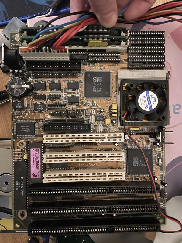

In case you don't know it, you can make a picture of your RAM modules.
Also you can make a picture of your board, that we can clearly see the writing on the SIS496 and the SIS497 chip.
Reply 4 of 32, by RagingSquirrel
Hey.. Thanks for your "kind" answear. My bad it is a 72 pin EDO RAM , also here is the photo from the mother board chips.. I also runned a memtest durring a whole night but didnt catched any error .. it has more that 20 pass and no fail at all, so i think the rams are ok ..
Reply 5 of 32, by CoffeeOne
RagingSquirrel wrote on 2024-02-15, 14:42:
Hey.. Thanks for your "kind" answear. My bad it is a 72 pin EDO RAM , also here is the photo from the mother board chips.. I als […]
Hi. Sorry for being not too friendly. But it is annoying, every 2 days there is a new posting, where somebody tries to run a 486 mainboard with EDO RAM. Noooooooo.
From what I see, your mainboard does not support EDO RAM, you have the "NV" chipset revision.
So change the RAM. Obviously memtest does not catch the error, but the Win95 installation does.
EDIT: Tomato 4DPS v2.1 board not posting
MORE EDIT: Did you intentionally make 2 links in your posting to the same picture? Better would have been both chips sis496 and sis497.
Can you make a picture of your RAM modules, too? Then we can double check, if it is really EDO.

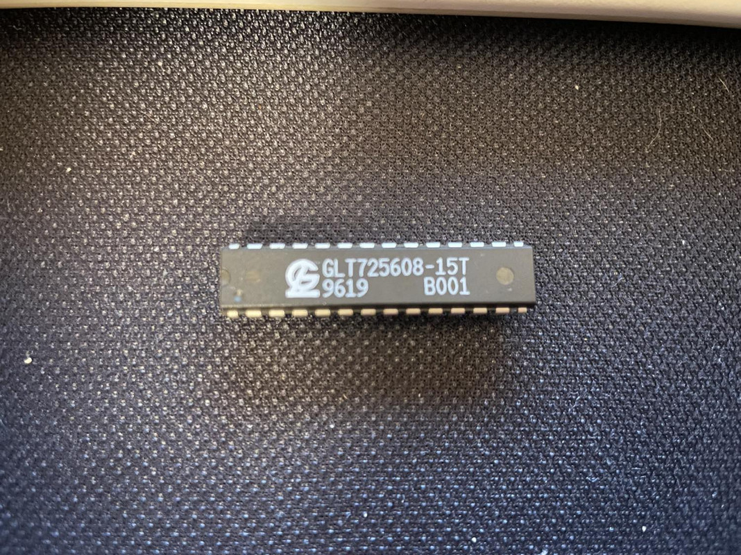

Thank You for your answer.. I ordered it.. one more question tho.. i was testing my mother board if it boots whitout the cache chips .. and accidentaly i fried one of them ,, that i putted back in the other way around. The board is still booting if i disable external cahe from the bios. So i searched the web for the same chip but couldnt find one .. i wonder if these things ar inter changeable.. could you suggest a replacement chip for this type of cache.. (as i said i am really new tio this. i was 10 years old when i had my 486 and i wanted to rebuild one.. but i have to admit is way harder than building a p3 for example..)
Reply 11 of 32, by CoffeeOne
RagingSquirrel wrote on 2024-02-15, 21:58:
Thank You for your answer.. I ordered it.. one more question tho.. i was testing my mother board if it boots whitout the cache c […]
Any SRAM 32kx8 15ns DIP28 should be fine.
like
https://www.ebay.at/itm/325252690343
Those chips are a bit expensive as it seems. You could risk buying it from China, but it takes a long time.
Reply 13 of 32, by CoffeeOne
RagingSquirrel wrote on 2024-02-15, 22:11:
Thank You
I noticed i got one if this with 2*14 pinn and 4 of 2*16 pinn what is the difference? Is it okay if i only change the 14 pinn one since thats the one i got fried.. ?
The 32pin ones (bigger ones) are 64kx8 SRAM chips. That gives you the 256kB cache. The tag ram (32kx8) is for "administration"
EDIT: hopefully nothing got damaged on the board.

Reply 15 of 32, by RagingSquirrel

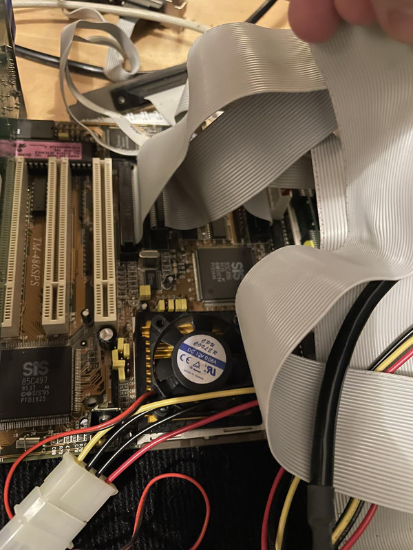

hay .. just a few more thing i noticed.. I keep testing the motherboard if it got damaged, and i cant really tell.. if i take out the 4 cache chip it boots normally (well it boots to dos and Win 3.11.. still not in Win 95), altrrough i read the manual provided in retro web... where it says the 4 cache chipp should work without the TAG RAM if the writeback function is disabled .. so i setted this option on write trough .. sinc there wasnt any disable option.. but its still not boot if any of the chips are in... Also i noticed, that my mobo doesnt have any cache chip jumpers.. where the manual describe it has to be 2 of those 3 pinn jumpers, to set it to 128 256 512 k caches.. now i am really clueles...
Reply 16 of 32, by CoffeeOne
RagingSquirrel wrote on 2024-02-16, 09:16:
Ohh.. dont even mention that..i am so mad about myself for screwing up.. I do hope its only the chip .. as i said if i disable e […]
Ohh.. dont even mention that..i am so mad about myself for screwing up.. I do hope its only the chip .. as i said if i disable extended cache in the bios it does pass trough the boot sequence, but freez on the Win 95 screen .. while before it i gpot the above mentioned error message.. anyway, i need your help because i really cant diferentiate these chips..
Would any of these work for me?
These ones are 512 k instead of the 256k witch i have that i understand.. according to my mainboards manual it compatible with 512 but i have to rearange a few jumpers..
https://www.vatera.hu/retro-pc-alkatresz-sram … 3342273560.html
These ones doesnt mention how many k s.. but it kind a look like what i have in my mobo..
https://www.vatera.hu/retro-pc-alkatresz-sram … 3344190743.html
These are whole sets and they cost the same as the one chip you sent me .. also they are being saled in my country so i can just grab them on the weekend.. i am also thinking, if i have to buy new chips i might just upgrade to it to 512k if thats possible to do.
I also noticed that is the last two numbers on the chips refer to ns (is that nano sec for some kind of refresh rate? ).. because both the above mentioned chip sets has different number on the 4 bigger than on the one "administration" chip.. is that a problem, or how does it work?
There are complete sets of 256kB cache, so very similar to your existing set. The chips with 512 are 64kx8, the chip with the 256 in the number is the 32kx8 tag ram.
The tag ram is faster in both sets, yes. The second set has only 20ns data srams, so that would be slower than would you have now.
Yes, you can upgrade to 512kB Cache, then you need a tag ram 32kx8 (the one with 256 usually in the number) and 4 times 128kx8, for example ISSI IS61C1024-15 .
Reply 17 of 32, by CoffeeOne
RagingSquirrel wrote on 2024-02-16, 21:45:
tag ram is always needed.
"where it says the 4 cache chipp should work without the TAG RAM if the writeback function is disabled". Where did you find that?
EDIT: Yes, I see, it is in the second manual. That is definitely wrong.
Maybe you can make a high resolution picture of the board (without cables blocking the view), then we might be able to help you with the jumpers.
MORE EDIT:
I would first install the FPM RAM, it does not make too much sense to test something with the wrong RAM type.

Reply 19 of 32, by RagingSquirrel
Here is the picture from my motherboard
EDIT: The guy whoom i am buying the cache cips from said, that if i dont have jumpers, it means that it might only support 256 k and eighter doenst gonna work with 512k or only 256k gonna be recognised.. Could it be that instead of jumpers it has to be setted in bios?
Eighter way .. i think buying the 512 k would be the best choice .. because price vise its the same...
