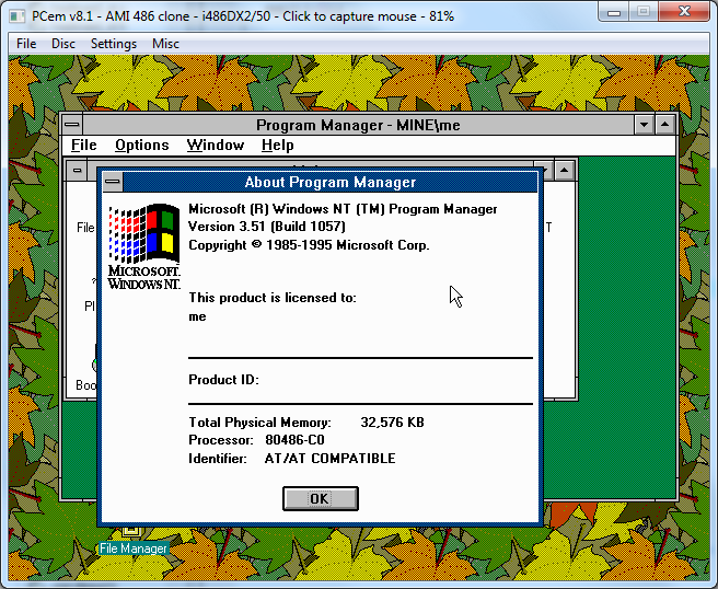

Reply 526 of 1046, by SarahWalker
There's also a bug in the IDE emulation (most register writes should affect both drives, not just the one currently selected). With that fixed NT 3.51 mostly works, some issues during installation but that might simply be a problem with my copy.
    48.14 KiB
    2472 views

Reply 528 of 1046, by ppgrainbow
While Windows NT 3.51 cannot be natively installed inside PCem, I believe that I will be doing a temporary workaround to install Windows NT 3.51 under Bochs or a old version of Qemu with no networking capabilities and standard VGA support as the current release of PCem has no networking capabilities at this time. 😀

Also, NT 3.51 installs fine here on PCem.
Thanks for the complement. I'm not good at programming and I believe that I might screw something up in any even if I compile my own revision of PCem. But nevertheless, Windows NT 3.51 works well with SCSI support as apposed to IDE which is limited to 504 MB.
For me, as for installing Windows NT 3.51, I had to install MS-DOS 6.22 first, copy the contents of the \I386 folder (from the Windows NT 3.51 CD) and type in WINNT /B to setup Windows NT 3.51 from the hard drive with no CD-ROM support. The only problem is that when the MS-DOS portion of setup completes, I end up with a blinking cursor in a black background and Windows NT setup does not proceed any further.
