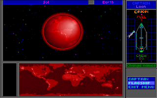

Yeah, that sounds logical. But still I'm confused, because I observed the same phenomenon as Miki Maus. The two images below are taken from Star Control 2 (original PC version) and the intro of Planet's Edge by using the dosbox / defend screenshot function (strg+f5). As far as I see screenshots taken this way are allways without aspect correction, so the resolution is 320x200 with square pixels and therefore with an aspect ratio of 16:10 (8:5). The screenshots should display a geometrically "wrong" image.
As expected poor earth in SC2 is compressed vertically (like a pumpkin).
But as you can see earth and moon in Planet's Edge are almost circles. And the game claimes itself to use 320x200, because that's the choice you get in the setup program. (you can choose between 320x200 for tandy, vga and ega display adapters). Furthermore, if you use aspect correction (to have the 4:3 aspect ratio) SC2's earth looks a little bit egg-shaped (the one of PE looks like a real egg)
What's the reason? Did I miss something?

Reply 8 of 31, by wd
Rank DOSBox Author
DOSBox Author
Well they claim that, no idea if it's true, they might even switch modes
to display some images.
The reason for what? If you're capturing screens you get the raw
image dimensions, ie. 320x200, which will usually display with wrong
ratio on any square pixel mode (paint program etc.)

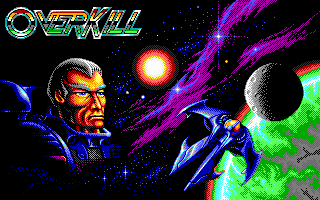

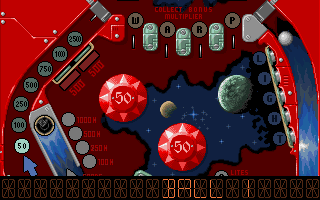

Yes they are, as I was talking about games that use 320x200, at least that are dimensions of screenshots and games take whole screen. But the graphics for these games were drawn without taking into account pixel ratio (or they are conversion from other systems, etc.) so they look better without aspect correction. Some examples:

Reply 10 of 31, by wd
Rank DOSBox Author
DOSBox Author
Yes but then you're talking about ellipses, not circles. I'm talking about circles
if they're displayed as circles on a real pc.
There are several games which got the aspect ratio of imagery wrong because
they assumed pixels to be square. Wonder if they ever looked at their games...

Pinball Dreams, which you showed a screenshot of, was actually developed with square pixels in mind. The original game was released for the Amiga computer, while the PC DOS port is, well, a port.
