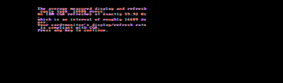

Reply 100 of 136, by Scali
superfury wrote:
So, essentially, all timing is based on the CPU cycles spent each instruction/HLT state. Or is there an error in the timing somewhere?
Well, there must be an error, because you see drift.
A CGA screen should take exactly 76*262 = 19912 PIT ticks. This does not seem to be the case, which is why things drift away.
Aside from getting the number of ticks correctly, for our effects to work, you also need to have the vsync and hsync timing correct. As in, the PIT is reset to the vsync state. The code assumes that the PIT is then in sync with the display, and the counter value corresponds to a specific place on screen. So that means your vsync states need to occur at the same time as they do on real hardware.
CPU timing is not that critical for these effects.

Reply 107 of 136, by superfury
Just broken in the debugger while the effect is running:
The VGA Horizontal Total is 40 character clocks(so 320 pixels rendered horizontally in total). The horizontal x counter is 913 at the end of each scanline, so 912 pixel clocks are rendered(each clock takes one pixel clock and increases it). Also one clock is taken by the horizontal retrace clock? Positions 0-911 are normal display clocks, clock 912 resets the counter and does nothing(missing a clock).
The Vertical timing is 1, so it's working on a scanline basis?
The vertical line counter is set to 224 when each frame renders.
The display resolution of each frame is 752x246 pixels(including overscan etc., which is determined by the horizontal and vertical retrace starting).
The vertical counter at Vertical Total is 262.
The clocks runs at 4x PIT speed, so (262*913)(time of a frame in CGA pixel clocks)/4=59801.5 PIT ticks.
This would be a whole number if the totalling and retracing didn't last 1 pixel clock to execute(so substract 1 pixel clock for every scanline and 1 pixel clock for a complete screen).
Edit: I've modified the HTotal and VTotal signals to execute the next clock(The first clock of the next Scanline's pixel) immediately. So now it shouldn't skip dot clocks on horizontal/vertical overflow. But the black bars still appear.
Edit: The Delorean car doesn't seem to disappear anymore now:)

Reply 110 of 136, by superfury
Well, after all that work, at least something has improved with recent commits(according to the CGA Compatibility Tester) 😀
14.31 KiB
954 views
Refresh Rate is CGA-Compliant.
Although the problem with the car is back, apparently. The only problem to actually occur(besides timing not being 100%) in the Compatibility Tester is the Start Address reprogramming test. The first screen is OK, but all other screens are vertically shifted down/up by 1 line(scrolling left) or horizontally shifted right/left by 1/3 screen(scrolling up). Does that mean there's a problem in my Start Address calculations?
