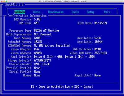

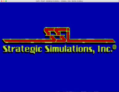

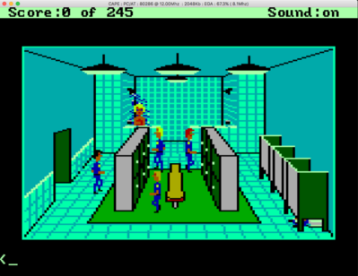

In the end I finally got EGA emulation working. Some screenshots: CheckIt, Sierra's Police Quest and SSI's Eye of the Beholder.
I had few issues like not correct timing, wrong hsync/vsync but once I fixed those the IBM EGA BIOS can properly pass its self test.
    105.32 KiB
    1000 views
    Police Quest
    96.12 KiB
    1000 views
    Eye Of the Beholder
    141.45 KiB
    1000 views
    CheckIt !
