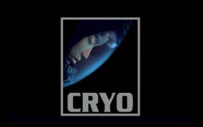

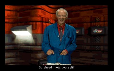

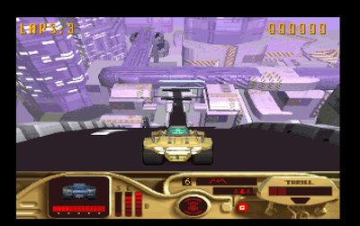

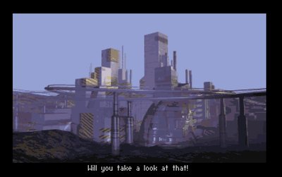

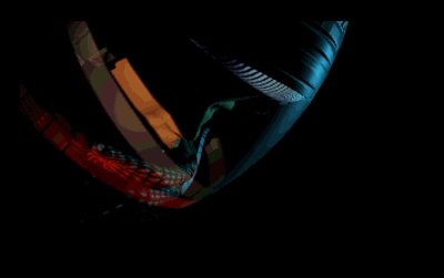

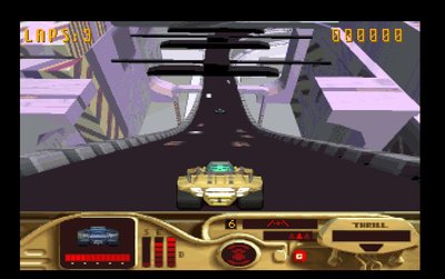

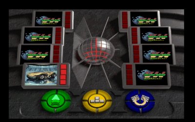

Now trying Megarace on the Compaq Deskpro 386 again. Audio and video seem to work now? Although slowly, at only 16% speed on a 4GHz Intel i7 4790K.
Edit: The Megarace demo now seems to run all the way into the gameplay itself 😁 Windows 95 setup still crashes on that BOUND instruction, though, for some unknown reason(the BOUND instruction faults and returns to the BOUND instructions without any modification on results).
Recording of Megarace audio when running the demo, as well as screen captures taken throughout gameplay in UniPCemu(using RALT+F5 to make a screen capture), on the Compaq Deskpro 386 machine emulation, with a 80386 CPU at 16MHz(only at 16% speed).
https://www.dropbox.com/s/riszsakskvt8cdg/Uni … ceDemo.zip?dl=0
30.24 KiB
1489 views
Megarace demo starting

Cryo logo

Megarace!

City display

Lance!

Reply 8 of 142, by superfury
91.13 KiB
1489 views
Selecting a car
101.9 KiB
1489 views
Gameplay starting
85.82 KiB
1489 views
And just before stopping the recording of audio.
