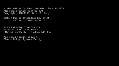

I'm trying to get the FDC working properly again on the XT(with a 80386 without any waitstates for faster testing), but for some reason, my floppy disk boots fine, until it's past the HIMEM.SYS driver, after which the floppy disk controller goes awry for some reason? It says:
Bad or missing VIDE-CDD.SYS
Error in CONFIG.SYS line 4
HMA not available : Loading DOS low
Not ready reading drive A
Abort, Retry, Ignore, Fail?
The FDC data shows that the last (correctly) executed command was a Specify command. The MSR is 0xB0, the floppy being ready to receive a new command. Specify doesn't raise any IRQ(which is according to various sources, like osdev and 82077AA datasheet). The MSR isn't read(and updated as such) after the specify command received it's parameters and executed.
UniPCemu Git repository

This is a log of the entire FDC booting MS-DOS 5.0 with HIMEM.SYS, then failing on the remaining parts:
40.65 KiB
600 views
Screen capture directly after the log.
debugger.log
369.52 KiB
41 downloads
Floppy disk log of everything the FDC does and gotten reads/writes.
Can anyone see what's going wrong?
