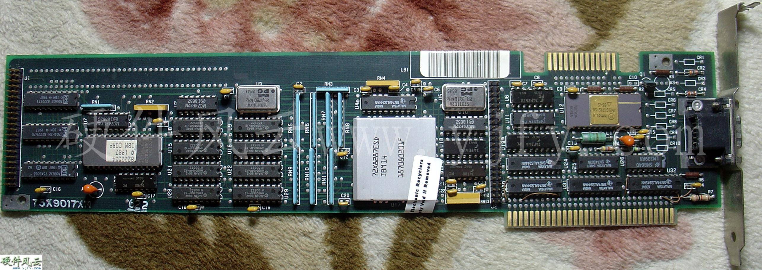

I did find this though, just for reference to superfury so he does not do anything overly complex regarding these clocks:
http://www.minuszerodegrees.net/video/IBM%20PS2%20Display%20Adapter.jpg - genuine IBM card, note the crystal frequency specified on this.
But, also found this a little disturbing:
http://www.yjfy.com/images/oldhard/video/IBM_VGA.jpg - again see the 28MHz crystal!

Postby superfury » 2017-11-27 @ 12:17
Just looked at it(rotating the images 180 degrees to read the crystal values easier). The 25MHz crystals both say 25.175MHz. The 28MHz crystal seems odd indeed: VGA=28.3210MHz, PS/2=28.3220MHz(So it's about 0.0010MHz off? So 1000PPM off? If it's limit is 30 or 50PPM, that's not supposed to work with a NTSC monitor? It's way off, even by their own standards?
superfury
Posts: 2611
Joined: 2014-3-08 @ 11:25
Location: Netherlands
Re: x86 software vs hardware clocks
Postby Jepael » 2017-11-27 @ 12:44
superfury wrote:Just looked at it(rotating the images 180 degrees to read the crystal values easier). The 25MHz crystals both say 25.175MHz. The 28MHz crystal seems odd indeed: VGA=28.3210MHz, PS/2=28.3220MHz
Note that it reads 25.175000 and 28.322000, which do indicate it's designed for that (within tolerance) and not to 25.2/1.001 for example.
superfury wrote:(So it's about 0.0010MHz off? So 1000PPM off?
No, how did you come up with that? It's 35ppm.
superfury wrote:If it's limit is 30 or 50PPM, that's not supposed to work with a NTSC monitor? It's way off, even by their own standards?
What makes you think so? TVs and monitors can lock on to the incoming signal that's way off that. Even digital TVs today must allow 0.5% tolerance, that's 5000ppm.
Edit: Having said that, video cards that have a single 14.31818... MHz crystal with PLL to generate the required clocks, won't be exactly that. A Tseng card with certain PLL can only generate clock that is 25.255681.. MHz, that's 0.32% error and I bet nobody can tell the difference, it will work just fine. It uses 14.31818 MHz * 127 / (18*4) to do that.

About the ET3000: A simple look at the cards oscillators shows all base frequencies:
http://retronn.de/imports/hwgal/hw_tseng_et3000.html
and this one uses 40 MHz instead of 36 MHz: http://retronn.de/imports/hwgal/hw_grap ... front.html
