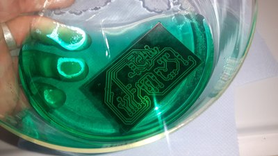

Reply 22 of 57, by mcobit
I also want to give the self made midi uart interface a second try.
Here is a picture of etching a prototype board in HCl with some H2O2:
