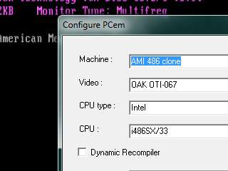

Reply 7 of 13, by Jo22
bluejeans wrote:
How can I enable it in pcem, there's no line for it in its' .cfg file?
In the menu bar, you can choose Settings->Configure to find a checkbox right below the emulated CPU type (486).
The line in the config file is "cpu_use_dynarec = 1".
