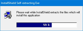

Installshield (v2-v3) "indy and the infernal machine", "monkey island 4", installed and played without problem. The "Installshield Self-Extracting" it takes 10 or more minutes to unpack the installer itself. (I have to try the phantom menace installer)

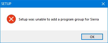

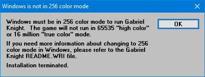

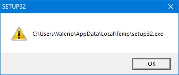

The Sierra installer "can" install games, but there are two problems 1: it cant create subfolders in "start/program" with a lot of error. 2: If the installer need 256 color mode the game cannot be installed.

    Sierra 256 color

    Final error in the Sierra Installer
    6.97 KiB
    4053 views
    Sierra installer cant create subfolders 2
    8.5 KiB
    4053 views
    Sierra installer cant create subfolders 1
    11.52 KiB
    4053 views
    59% After 6 minutes
You can set the 256 color compatibility mode in properties just like any other program but it only pretends to be in paletted mode which work fine for software like the incredible machine and battle chess which don't use any palette tricks but gabriel knight (which otherwise works in top of tree) has display issues. Note that in Windows 8 and 10, 256 color mode isn't supported at all so actually changing the video mode won't work on those versions anyway.

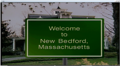

The Tandy VIS exclusive game "The Secrets of Hosea Freeman" runs too (in a window rather than fullscreen). There's a patched binary at archive.org that fixes the crashes from VIS exclusive features.
    235.21 KiB
    3894 views

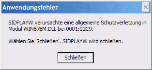

Edit: Interesting. SIDPlay (W16) causes an exception error in win87em.dll
on an Win XP system when playing certain songs (like Turbo Outrun SID file, track 3).
So there seems to be an other justification to have an x87 math co-processor
installed in a vintage rig (386, 486SX).. 😁
    4.23 KiB
    3610 views
    Win16 program has issues with real NTVDM on XP..
