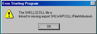

I have a Windows 98 virtual machine, but I got an error: The SHELL32.DLL file is linked to missing export SHLWAPI.DLL:tFileAttributesA.

Are there ways to address this problem?
Reply 1 of 1, by 1541
This is a known issue due to your host CPU, see
https://communities.vmware.com/t5/VMware-Work … ils/m-p/2283642
Fix:
https://github.com/JHRobotics/patcher9x
