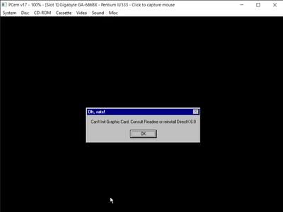

I have this issue with pcem when emulating win 98, it runs fine but when I open a game like hot wheels stunt track driver it gives this error. I did install 3dfx tools and stuff so whats the problem?

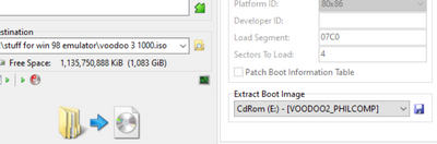

Reply 14 of 23, by tecker
Gmlb256 wrote on 2023-01-20, 20:46:
tecker wrote on 2023-01-20, 20:43:
Gmlb256 wrote on 2023-01-20, 20:37:
Yes, ImgBurn or a similar program is enough for creating a simple ISO image.
is it required for it to be a bootable image?
No.
it should look like this?
21.94 KiB
1289 views

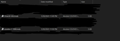

Reply 16 of 23, by tecker
Gmlb256 wrote on 2023-01-20, 21:10:
Yes, but the format should be ISO. […]
tecker wrote on 2023-01-20, 21:00:
No.
btw I downloaded this version of voodoo 3 so it should possibly come with DirectX 6 right?
The driver doesn't come bundled with the DirectX redistributable, but that should already be installed on the emulated computer. Besides, the last one that doesn't require DX7 is dated 21 Oct 1999.
like this?
60.3 KiB
1273 views
hm. so do these 2 come with DirectX 6 redistributable? or do all of them don't come with redistributed DirectX 6?

Reply 17 of 23, by eddman
Don't make things so hard for yourself. If you read the readme of the driver you downloaded from archive.org, it says the version is 1.07.00, and it needs DX7.
Simply download DX7.0 or DX7.0a, put it in an ISO file, open it in PCem and install it.
No need to mess around with older drivers, specially a super old one like 1.00.
EDIT:
These drivers do not come with DX included. That text simply means which version of DX is required.
You haven't mentioned which exact 98 you're using. If it's 98 SE, it already comes with DX6.1a.
Reply 18 of 23, by Gmlb256
tecker wrote on 2023-01-20, 21:32:
like this?
Yes.
None of them come with the redistributable, just only the driver.
so if I downloaded this one on emulated win 98, it will install DirectX 6, or do I have to install DirectX 6 manually?
If it is the Windows 98 SE, it will come with DX6 installed already.
