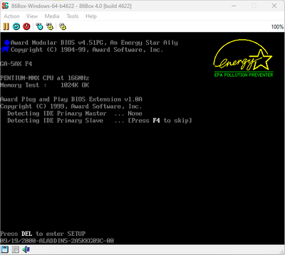

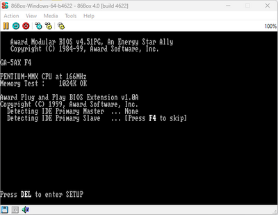

When I tried various video cards with 86box, I noticed that the ISA video card did not display the image, but the PCI video card displayed the image.
This seems like classic wisdom, but I'm in my 20s and don't know why. why?

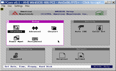

I think that those logos make use of VGA's ability to load custom text fonts.
So it's perhaps not using graphics mode, at all, but VGA text-mode.

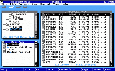

Mouse drivers and programs like PC-Tools used a so called "TUI" interface (text-mode user interface) based on custom text fonts.
That's how DOS Shell works in VGA display mode, too.
The WinBIOS 486 machine type in PCem/86Box uses a TUI, too.
    17.25 KiB
    1046 views
