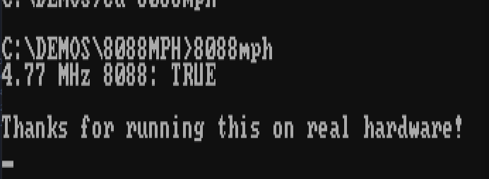

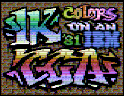

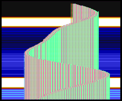

I haven't been 100% satisfied with my CGA composite simulation and wanted to improve it a bit before making a final video. But here are some screenshots...

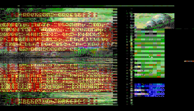

Finally the end credits look slightly garbled?
66.42 KiB
3287 views
Garbled credits
It's almost like every 8 scanlines it's off by 1 character clock (shifted to the left)?
Its seems to match the pattern seen at the right border of the active display?
The effect on the bottom half of the screen looks to be running fine, although has the same issues as the top half (but mirrored vertically ofc).
It looks like the start each scanline of the credits is sometimes moved left by 2 or 3 character clocks. This static pattern seems to repeat on all scanlines?
Like:
0
3
0
0
0
0
0
3
0
3
(repeated for the entire height of the screen)
The above being character clocks shifted left.
It doesn't seem to move in any way while the credits are playing, so that would be an indicator it's properly running in cycle-accurate mode and the top of the screen is at a non-moving position (so that's correct at least)?
So basic scanline timings would be fine, but within seems to depend on what scanline it's rendered at (with some scanlines shifted off-screen, depending on line number modulo something)?
The wavy line effect seems to be running fine on the credits screen. It's just the characters being shifted probably, depending on the line number (it seems to be static accross the screen and not moving, which is a good sign)?
Looking closely, you can see that the pattern of the red sun shifts matches the pattern on the right border (sun shifted left equals added pixels on the right border of the image).
1:22:18 of recording: Viler greets message with 2 rows done. Very slow at 2% realtime speed 😒
Edit: Thinking about it, the shift to the left is exactly one character width in the font displayed in the red background? Don't think that's a coincidence.
After all that, luckily no spaghettification detected. So the main weird things that happened was the chaplin/alien/etc. image being superimposed on a part of itself somehow (running at 2% as well), the overscan always being black (except at the end on the intro it became blue until 'widening' happened, black for the remainder of the demo), the credits having a off-by-one character issue depending on the scanline on the screen (it has a distinctive pattern repeated accross about every 8 or 16 scanlines). It looks like it's repeating every 3 text rows at the credits (the 2nd text row having something extra shifted). The first extra shift being at the greets rows (right at the first and third scanline of it).

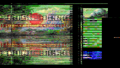

Pattern distinctively noticed during Reenigne greets part a bit before the end of the credits.

superfury wrote on 2023-05-30, 09:59:

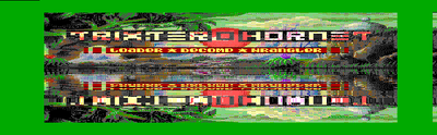

You're on to something. The graphics in memory are indeed shifted by one byte (one character column). This is due to a trick where the two rows of one CRTC frame are cleverly organized so that the second rows of all the CRTC frames can be stacked. The first 'row' of each CRTC frame is a single character wide column, cleverly hidden in the right overscan.
21.28 KiB
3253 views
Area 5150 end credits trick
No such trickery is occurring. Each scanline is pretty much set up the same way. Since the CRTC updates are all cycle-counted though, if you are off at all you may see scanlines of different shapes and sizes occurring, sometimes with interesting patterns. I saw a lot of different kinds of spaghetti in my debugging...
Actually, that's a bad sign. If you see two static scanlines at the top of the screen, some space, and then the garbled output, that means the effect ISR is late. It is set to repeat every screen with a reload value of 19912. You get two scanlines just from the last values programmed into the CRTC. The interrupt should trigger *above* those two lines late on scanline 20, entering into the ISR procedure itself around scanline 21.

Edit: Took the parts of the recording that fail and made some shorter clips of them from the large (slightly over 2 hours long) recording of the entire demo running inside UniPCemu:
https://www.dropbox.com/s/qyjillfqkd80kry/202 … 150%20.zip?dl=0
As you can see, the vector part has the issue of the area above and below the graphics area (between the graphics vector area that's bouncing up and down and the top/bottom text areas of ANSI from hell (it looks like ANSI from hell at least)) is black instead of the proper light cyan color.
A small part of the credits running is also included. As can be seen, the image that's rendered is stable on the CRT output. It's just that the contents are shifted on some specific graphics rows (or text rows, don't know what mode it uses, didn't check). Say if it's for example shifting left on scanlines 1,3,7,14 (not really those, but just an example), it's doing that for every frame at exactly the same scanlines, which never changes during the entire credits (so the entire output is stable in that way). So at least the entire amount of pixels in a frame is constant. The display isn't bobbing or distorted in any other way (stable output resolution and active display area).
The part with the alien is recognisable, with a part rendering 'correctly' (the elephant), never being morphed in any way during the animation.
