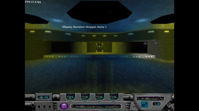

Reply 1328 of 1558, by sharangad
Nightly snapshot:
https://1drv.ms/u/c/5277ef8d4f2a9dcf/EeUuYi0S … PbYNDQ?e=ciyYMo
MD5: 3f64b5e65c7bd2d052ba71c1a9d59470
CPU load lowered, instability fixed (thanks @ripsaw-8080 for pointing out how to handle thread safe DMA in Dosbox).
There may be rendering defects (Whiplash menus in DMA mode has issues, [ALT+X] in ICR2 also has audio sync and framerate issues. The reported frame rate is in the hundreds, but the actual rate is in the 40s. The car can be controlled just fine though, which is weird).
There may be more problems. Tomb Raider also may have new issues with the menus when existing a game. The background image may render and there may be some instability.
[EDIT]This now runs on my Sandy Bridge i7 with HD2000 at 5 fps instead of crashing after the second frame. Once again many thanks @ripsaw-8080.

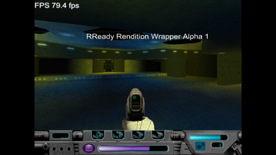

Reply 1329 of 1558, by sharangad
And here is a gratuitous demo of Rebel Moon:
https://youtu.be/8_pk8TbufXs
No graphics fixes, just the built-in demo in its entirely.
