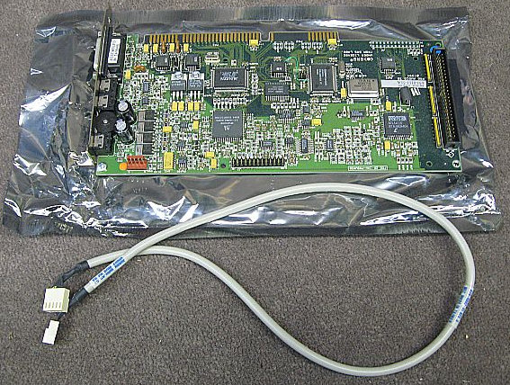

I bought one.
http://cgi.ebay.co.uk/ws/eBayISAPI.dll?ViewIt … em=370458989594 (Quantity remaining 2, $10 each.)
It's a pity it doesn't come with the 4MB Korg wavetable daughterboard, but I guess for $US 10, that was to be expected. Nevertheless, I think it's a good buy. I have a Korg Topwave 4MB DB I can attach to it.
Reply 2 of 17, by akula65
If it doesn't include the Korg Wavetable card, it's actually a Premium 3D card. I have one that I got as part of a MediaVision MV2200 Multimedia Upgrade Kit. It has the PROAUDIO 3D sticker next to the SCSI-II interface, but shipped without the Korg card, hence the Premium 3D designation.
Did it ship with any software, drivers or documentation?
Reply 3 of 17, by retro games 100
^ Yes you must be right, it's a Premium 3D card. In gerwin's soundcards ISA.txt file (found here), there is this entry:
Premium 3-D MV JAZZ 16 chipset, built-in SRS surround sound, comes with KORG Wavetable daughter board on WBH.
I guess this card was sold with and also without the DB. There's also the possibility that the DB was removed, prior to it being listed on ebay. It's unlikely that the seller will include any software, drivers or documentation, because they are not mentioned in the ebay listing. Please note that the item hasn't arrived yet, because I only bought it yesterday! 😀
