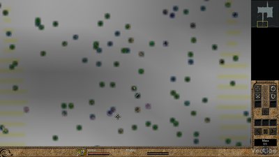

Total Annihilation Kingdoms works now, but something's wrong with the fog of war effect:
Reply 962 of 3949, by Dege
ZellSF wrote:
Star Wars Episode 1 Racer looks much better now.
Hmm... I have only the demo.
How should it look? How could I reproduce the fog of war? (I don't know this game, never played with it.)

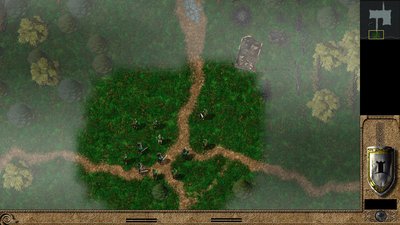

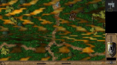

Reply 963 of 3949, by ZellSF
Oh that seems to be a map specific fog of war effect (first map of the campaign), not in the demo, comparison follows:

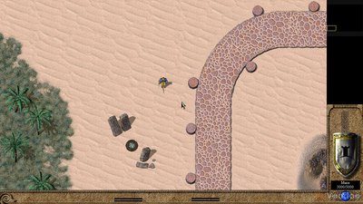

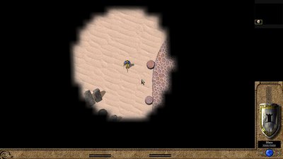

Seems to be another game reliant on ATI colorkeying btw...
Another problem that's actually in the demo this time (start a skirmish without the map revealed and with unit reveals line of sight option). Fog of war doesn't work at all in dgVoodoo2 (and neither does updating the minimap):

I fixed Galshell and Empire Earth, however still uncertain about TA Kingdoms demo. It seems to work fine for me with ATI:
(However I get unreadable text letters with nVidia, I'm gonna check it all again)

Reply 969 of 3949, by ZellSF
oh, apparently it's higher resolutions that are broken. Try running it in anything higher than 640x480.

Reply 973 of 3949, by Dege
Thanks! Now I found the bug and fixed it.
