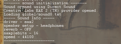

Reply 131 of 435, by KainXVIII
Is it possible to make reverb work in Alice on period correct pc? Because in win10 with alchemy game console shows this

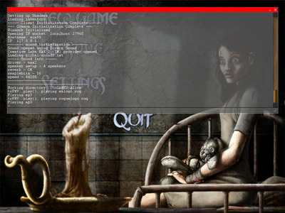

Reply 132 of 435, by Joseph_Joestar
KainXVIII wrote on 2024-10-06, 21:51:
Works fine under Win98 with an Audigy 2 using VxD drivers. The game auto-detected EAX2 on startup, and set it up on its own.
188.03 KiB
1245 views
Might be another case of games from that time not working 100% correctly with WDM drivers and/or ALchemy. Baldur's Gate 2 and Need for Speed 3 are two other examples. I've added a note to the wiki regarding Alice.
Reply 133 of 435, by KainXVIII
Pity, i think the only thing that Alchemy do in Alice on my machine is some kinda of surround'ish sound added, but no reverb (compared to Miles option).
PS - also same situation in Hitman: Blood Money if i remember correctly..
Reply 134 of 435, by DrLucienSanchez
I can confirm, after trying this just now, that no reverb is enabled for Alice on Windows 10. Alchemy picks it up automatically, you set to EAX2, it appears to work as the positional sound is fine with the stone moving back and forth on the first level, but Reverb No show in the console, this is with EAX and EAX2, and I tried A3D as well.

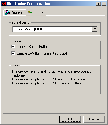

Reply 136 of 435, by Joseph_Joestar
KainXVIII wrote on 2024-10-04, 08:35:
According to this https://www.gog.com/forum/the_suffering_serie … nofficial_patch there is no EAX support in The Suffering series (just a placeholder?).
So I took a look at the two games from The Suffering series (GOG versions). Apparently, GOG ships the first one with the IndirectSound wrapper, which I deleted, as I'm testing it on WinXP using real hardware. The game's configuration utility correctly detected the 128 hardware voices on my X-Fi Titanium, and it allowed me to tick the "Enable EAX" checkbox:
6.74 KiB
2667 views
There's also an "Environmental Audio" setting under in-game audio options, which was turned on by default on my system. Now, I can't tell if/how the game actually uses the capabilities of EAX hardware, but the developers did include the proper checks at the very least. The second game uses the same configuration utility as shown above, but it lacks the in-game "Environmental Audio" setting.

Reply 138 of 435, by RetroGamer4Ever
KainXVIII wrote on 2024-10-07, 09:03:
I wonder if anything can be done with that (via mad hacking skillz) 😅
Like most older games, it uses a text file for config info/settings, so changing the text in the file for sound settings should enable it, as that's how you did it back in the day, when the settings didn't auto-config properly.
Reply 139 of 435, by KainXVIII
RetroGamer4Ever wrote on 2024-10-09, 10:56:
Yeah, that's what i tried in the first place, but can't find anything related to reverb in my cfg file
upd - but i found (by selection method) s_reverb command in game console, will try to enable it and see if anything changes..

upd2 - yes, after putting seta s_reverb "1" command in config file reverb now shows as enabled in game console (but i failed to hear any difference 🤣)
@Joseph_Joestar do YOU hear any reverb effects on your machine? How its compared to Miles option? And if yes, where specifically on level i can test it
