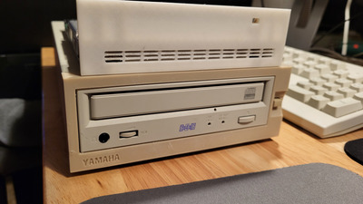

Anyone in luck finding some beige PLA filament? Or is painting still the way to go.
I'll share both STL and Fusion files, if anybody wants (it could be ½-1 mm narrower, I guess - or it may be my printer not being trimmed properly.
https://www.bulgin.com/us/products/front-pane … -connector.html
I've tried every color in my local store that looks like "beige PC", but alas, nothing REAL good. I like "bone white" the best since it has a yellowed-PC kinda color. I've had good results doing several layers of white before going to bone, which DOES add some realism. The "Creality" branded "White" was a good one, too. Inland white was too white.
1.06 MiB
754 views
Creality "White" on top, Inland "Bone White" below
I'm still hunting for the perfect beige, but it's going to take a while unless companies start making sample packs...

Yeah, samples would be nice, because a full spool of a color that doesn't match, would sit ontouched here like forever ...
But good input with "mixing" like one or to layers of one color and then switching to like a white or black ...

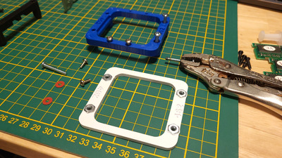

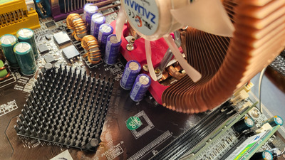

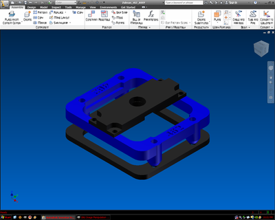

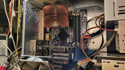

I was LUCKY as a DUCKY last weekend as I found a WHOLE PC in the dumpster. It had another CNPS9500 in it!! That is the Beez kneez, man! I love that cooler!
It was also another opportunity to test out the socket 462 Bracket I made for the CNPS9500 a while back.
116.61 KiB
652 views
Assembly View
Excellent. It's good. Good enough to share now.
I use 1" screws (6-32) to mount it. I also put mica washers on the bottoms of the legs, for safety. The backer just needs the nuts melted in and it is ready. The top piece is just screwed down with screws designed for plastic (salvaged, but very common).
1.78 MiB
652 views
Most of what's involved
Install the lower bracket first, then sneak the cross part in there and the hardest part, screwing those screws in at severe angle. I pre-screw the holes, so they're threaded, which made it fairly easy.
1.81 MiB
652 views
Last screws - Tight fit (mounted outside of case)
As for the printing of such brackets, I'd advise 100% fill and .1mm layers. I have PLA+ and ABS test subjects. They both work the same. The PLA+ is easier, of course, to melt the nut into the backer.
I've been gaming fairly heavily on my CT-7NJL6/A-XP3000+/R9600XT and it is cool 'n quiet (finally). CPU temp never goes above 45C under any circumstance (ex. fan off) after hours of gaming. It was getting to 60+ with the stock cooler with the whiz-bitch fan on it. I can actually tone down the fan with such a large cooler on it.
1.77 MiB
652 views
Test Computer One (Other is A7N8X-E/A-XP3000+)

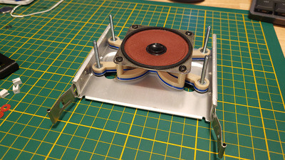

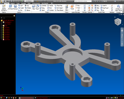

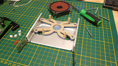

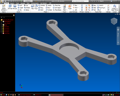

You ever put together a computer and wonder: "Where in the hell does the PC Speaker go?" Nowhere. The answer is nowhere. That case is too "modern" to accommodate for that.
122.47 KiB
589 views
PC Speaker to 3.5" Bay Adapter 1.0
Here is the 3.5" Bay to PC Speaker Adapter. Fits basically any case that uses the bottom holes of the HDD to mount. It was made for the speaker shown, so it has the screw towers. I have included a version without the wings, as I have plenty of "regular" PC speakers as well. I will use hot glue to mount those ones.
1.87 MiB
589 views
The Usefullness of it!!
1.85 MiB
589 views
Ahhh, very bloopy.
113.51 KiB
589 views
PC Speaker to 3.5" Bay Adapter 1.0 (no wings)
I'm out of appropriate screws, so I can't install any yet.

Reply 30 of 102, by H3nrik V!
I love the very organic look of that!

It's a smart idea. I'd have used magnets since most cases are metal - it allows you to place it near unused fan openings for better sound. It's a cool idea to use unused drive bays though.

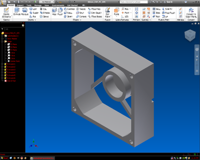

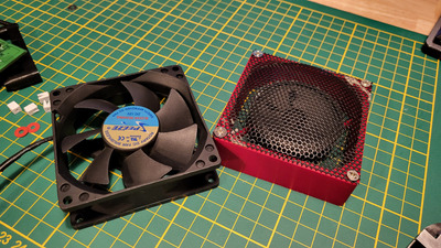

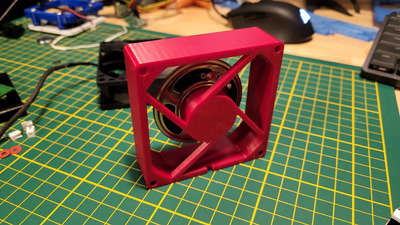

Ah yes. Unused fan openings you say? 🤣
142.41 KiB
498 views
PC Speaker to 80mm Fan Adapter
I was inspired and made these today. Pretty cool. Too bad I only have red left...
1.6 MiB
498 views
Front, testing the holes. Regular PC fan screws
1.72 MiB
498 views
Back
I have a 80mm and 120mm variant for now, will work on a 92mm one later.

That's more my thing! older cases often have unused fan openings.

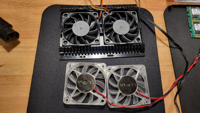

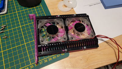

Sooo... You know, some times I have an idea and go "Oh, hell yeah" and then later.... Welll, 🤣 I wanted to share one of those times, 🤣
I have this Ultra HDD cooler that uses two 60mm fans, right? Kinda useless... BUT, what if I just used it to cool my hot-ass GPU? So I made this goofy bracket, to try and make a sort of "conversion kit" for HDD coolers.
1.65 MiB
384 views
Ultra 3.5" HDD cooler
1.43 MiB
384 views
Cooler on Bracket

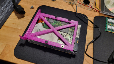

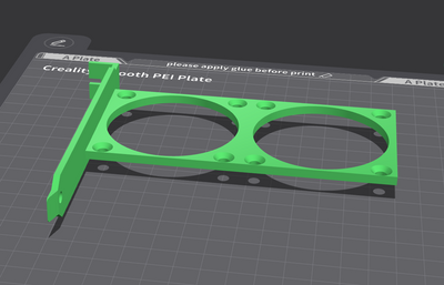

Hmmm... Didn't work due to some issues that were obvious (I could make it work) so I decided to go a different (better) route. Just making a adapter for two 60mms. This should be good.
113.34 KiB
384 views
New Bracket

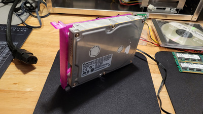

This 3.5" drive attached is quite comical, though!!
1.63 MiB
384 views
Drive Attached
