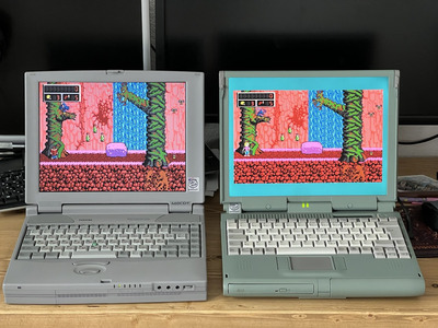

3lectr1c wrote on 2024-12-28, 06:25:
It's certainly not a perfect scaling. Picture is squeezed. Proper one is scaled to fullscreen.
Sample from my collection. Left is good scaling and right one is bad, inproper.
157.03 KiB
1173 views
262.26 KiB
1176 views
You want the type of scaling that this laptop and your Siemens Nixdorf does - the fullscreen scale breaks the aspect ratio. That’s what causes games like Keen 4 to glitch and text to get all messed up. DOS games weren’t even designed for 4:3, they’re 320x200/640x400. The most accurate scaling is that which preserves the aspect ratio so nothing gets stretched out of proportion.
If you just prefer to play fullscreen with the messy text, then that’s fine, but is not accurate scaling.
320x200 may well not be 4:3 pixel aspect ratio, but it was definitely displayed in that aspect ratio on all of the millions of VGA monitors that DOS ran on in the 80's/90's.
I'd argue that playing those games with purely integer scaling on a laptop LCD (with the resulting top/bottom borders) does not replicate the same aspect ratio that we had on CRT monitors.
Whether the vertically squashed linear-scale output, or the scaled-up (possibly pixellated; depending on scaling capability of the video chip) output is more preferable is going to be entirely down to user choice. But I think it is wrong to claim one or the other is 'most accurate'. Neither accurately reflect what those games looked like on a native CRT.

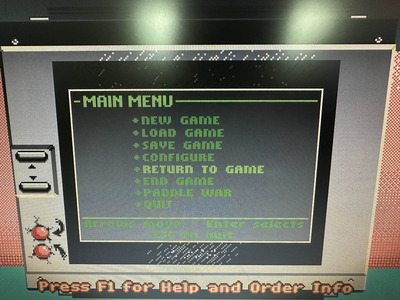

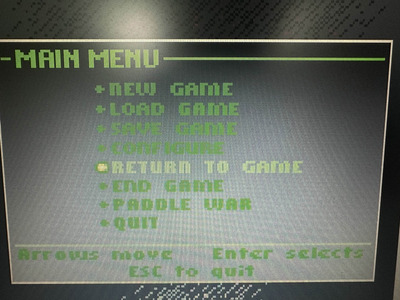

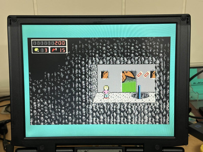

I see what you're saying, but it's a little more complicated then that. Yes, vertical scaling generally looks and works fine, which is why my absolute perfect DOS laptop is one that has a 640x480 LCD and does a vertical scale, meaning it fills the entire screen, versus some 640x480 laptops that will display DOS games as 640x400. However, since 800x600 and 1024x768 screens can't do a perfect 1:1 scale from 640x400/480 or 320x200/240, it messes with the graphics in an unintended and negative way. That's also what causes certain games like Keen 4 to have visual glitches.
Here's a few photos of the Keen text to serve as an example.
These first two were taken of my Alpha-Top Green751, which is a Pentium 75 laptop with a TFT 640x480 LCD and C&T 65545 graphics. This laptop is my current go-to for DOS games because it's a good machine, and because I can use a keyboard function key to switch between "native" scaling (320x200 -> 640x400) or vertically stretched scaling (320x200 -> 640x480). Not many laptops will let you pick between the two.
First image is in native scaling, second is with vertical scaling. Both look good.
1.11 MiB
781 views
1.21 MiB
781 views
This third image was taken of my CTX EzBook 700, which has the NeoMagic NM2093 graphics (MagicGraph 128ZV). This laptop always scales to fullscreen with no key or BIOS option to switch to black border mode. Since it's an 800x600 LCD, it does the typical bad fractional scaling to fill the whole screen, that as you can see looks awful. NeoMagic chipsets were the worst of them all in this regard, but the Cirrus and C&T chips were hardly better and still have scrolling glitches in Keen.
1013.6 KiB
781 views
Finally is the Brother Meritus A53 (1024x768 LCD) which scales up the 320x200 natively to a "big enough" image that still leaves some borders, but far less than leaving it un-scaled. For whatever reason, text looks the same as on the NeoMagic despite it not doing a fullscreen scale. That being said, it's still better than the typical fullscreen scaling because it doesn't cause any bugs in Keen or any other game that would be affected on an earlier laptop.
1.33 MiB
781 views
1.18 MiB
781 views

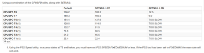

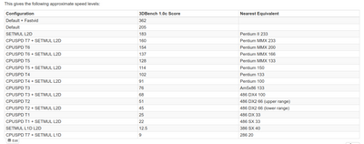

Benchmarks for the Thinkpad 240 (Mobile Celeron 300), using several slowdown tools.
- The IBM 'PS2' tool has a 'SPEED' parameter which you can use to set the following values:
--- FIXEDMAX; the default 300MHz
--- FIXEDMEDIUM; 225MHz
--- FIXEDSLOW; 150MHz
--- FIXEDMIN; this seems bugged and gives results closest to FIXEDMEDIUM
--- Plus some others that are more for mobile use (i.e. not really for setting a specific speed)
- Setmul works to enable and disable L1 and L2 cache; which CPUSPD cannot do itself.
- CPUSPD works to set frequency duty, from a state of T1 (lowest duty) to T8 (highest, and default clock) - that's all it can do with the P2/Celeron and this chipset, but that by itself is pretty extensive, as we will see.
Using just the PS2 SPEED parameter and SETMUL gets some decent slowdowns, but it's very spiky and with some odd performance drop-offs, more than might be expected:
67.71 KiB
705 views
Using CPUSPD and SETMUL is much more granular:
65.82 KiB
705 views
Values other than T8 or T7 in CPUSPD don't seem to work if you have set "PS2 SPEED FIXEDMAX". This seems to make the system reset to the highest duty state (T8) shortly after issuing the CPUSPD command. Fortunately if you want to use a state lower than T7, issuing a "PS2 SPEED FIXEDMEDIUM" and then the required CPUSPD command appears to make the lower duty levels work correctly.
This gives a rough spread of equivalent machines to include most of the more popular PC gaming eras, including the ubiquitous DX2-66, low-end 486 and high-end 386. It can also just about do the equivalent of a top end 286; matching the scores of some of my better performing 20MHz boards:
94.44 KiB
705 views

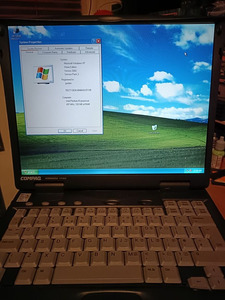

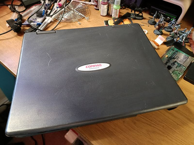

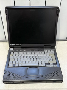

My cheap Compaq Armada 1750 arrived today. As expected it was not devoid of issues, but on the whole I am pleased with the condition. As advertised; quite grubby:
784.63 KiB
368 views
Today, after a little clean up with a magic eraser, soap and water, just a few minor blemishes on the top case (looks worse in photo than it actually is):
85.86 KiB
368 views
130.27 KiB
368 views
It's a mid-range spec of 1750:
- P2 333
- 128MB (64MB + 64MB)
- ATI Rage LT Pro 4MB
- ESS Audiodrive 1869
- 14" 1024x768 screen
- CD
- 6GB HDD
- No modem/ethernet
Good points are that it all works, including the drive (which has a working install of XP SP2 on), the FDD and CD work. Screen is clear and free of any blemishes/dead pixels, sound/speakers works.
Bad points; no main battery module, the CMOS battery is flat and the bezel around the screen was loose (cracked retaining clips) on the left edge of the screen.
I've already glued the screen bezel and just need to figure out the easiest way of replacing the CMOS battery (a 2032, by the looks of it). I'd also like to get a battery for it.
One thing I have read up on these machines is that they can take faster MMC-2 modules.... and I happen to have a Pentium 3 650 MMC-2, that I bought new for peanuts about 15 years ago. I understand that you lose the speedstep ability, and that they constantly run at the lower frequency (i.e. -150MHz under rated speed; hence 500MHz for my 650 module)... but that since the chipset is on the MMC-2... everything then gets boosted up from the (current) 66MHz bus the 1750 uses at standard.
The other job I have is to replace the internal HDD with an mSATA drive... but I believe I need to do something with a Compaq soft bios boot floppy or similar to do this (some bios data is held on the drive, ISTR?).

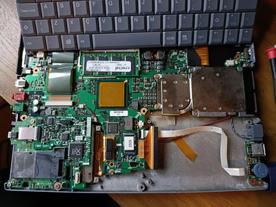

I just took a gamble on another pair of Sony Vaio laptops. This time a PCG-Z600RE and PCG-Z600TE - UK/Euro versions of the PCG-Z505HS and PCG-Z505LS.
One has a 2.5MB NeoMagic 256AV vga and a 500MHz PIII, the other has 8MB ATI Rage Mobility M1 and 700MHz PIII. Both have Yamaha YM744B/DS-1/XG audio. Both have a very nice magnesium alloy case - it's really quite sturdy. They also don't have a suicide power control board or leaky NiCd/NiMh, from what I can see (so far).
Sadly I've only been able to put together one working machine from the two (of course I chose the ATI-equipped model!) - with a combination of torn ffc cables from the keyboard and track pad, missing hard drive ffc and only one keyboard. They were cheap for the pair though.
466.55 KiB
194 views
476.38 KiB
194 views
On closer inspection, and from the BIOS menu, it turns out that what I thought was the Z600TEK is actually a Z600HEK; the difference being a PIII-800 in the HEK, in place of the 700MHz model in the TEK. So that's a result, I guess.
It only had the base 128MB ram fitted, so I swapped in a 256MB SODIMM, and it's registered all 384MB, which is nice. I also dropped in the 128GB mSATA drive from the last Vaio I tried (PCG-F807K). Boots fine, and speedsys confirms it seems to be working as expected. It's doing the nice, non-integer, interpolated upscaling that RAGE LT and later chips do, which is why I wanted it.
The case needs a bit of tidying up, and it was missing every-single-damn-screw! Also a few plastic trim pieces (mainly around the USB port on the right).
It will need putting through it's paces of course... and as yet I don't know if the battery charges/holds a charge.
